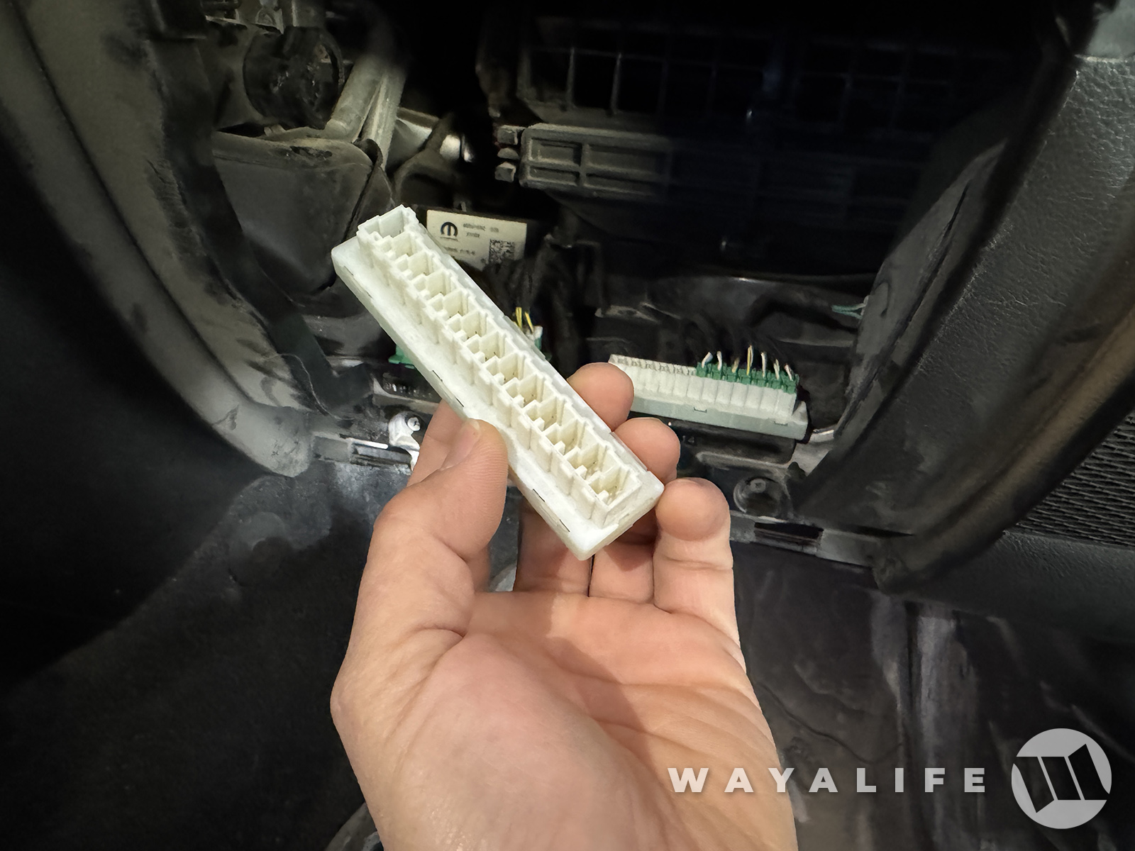

Well, another thing that it's definitely not is this - the star connector.
At this point and time, I've about run out of ideas. The head unit is about the only thing I haven't changed out and I'd hate to buy one of them only to find out that it wasn't it.
