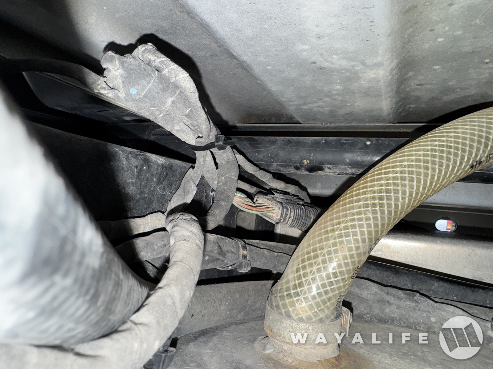

So, I may have made some progress today!!! Checking over all the wiring close to the passenger side rear corner, a lot of it was just sitting on top of the new gas tank and left to bounce around. I took a lot of time rolling them over to see if I could find any chafing and while I didn't, I did notice imprints/indents in the harness in a few places where they were making contact with the tank and or the cross member. After seeing this, I tried pushing what I could out of the way and then went for a test drive...
What I can tell you is right off the bat, EVERYTHING worked great. No errors, lights worked and I should note, for a very long time. On the way home, I did go over a stretch of road that is rough and bumpy and after about half a mile of this, I finally got a passenger side rear turn signal unavailable message.
Needless to say, I think my problem is somewhere around here and I'm getting close (y)

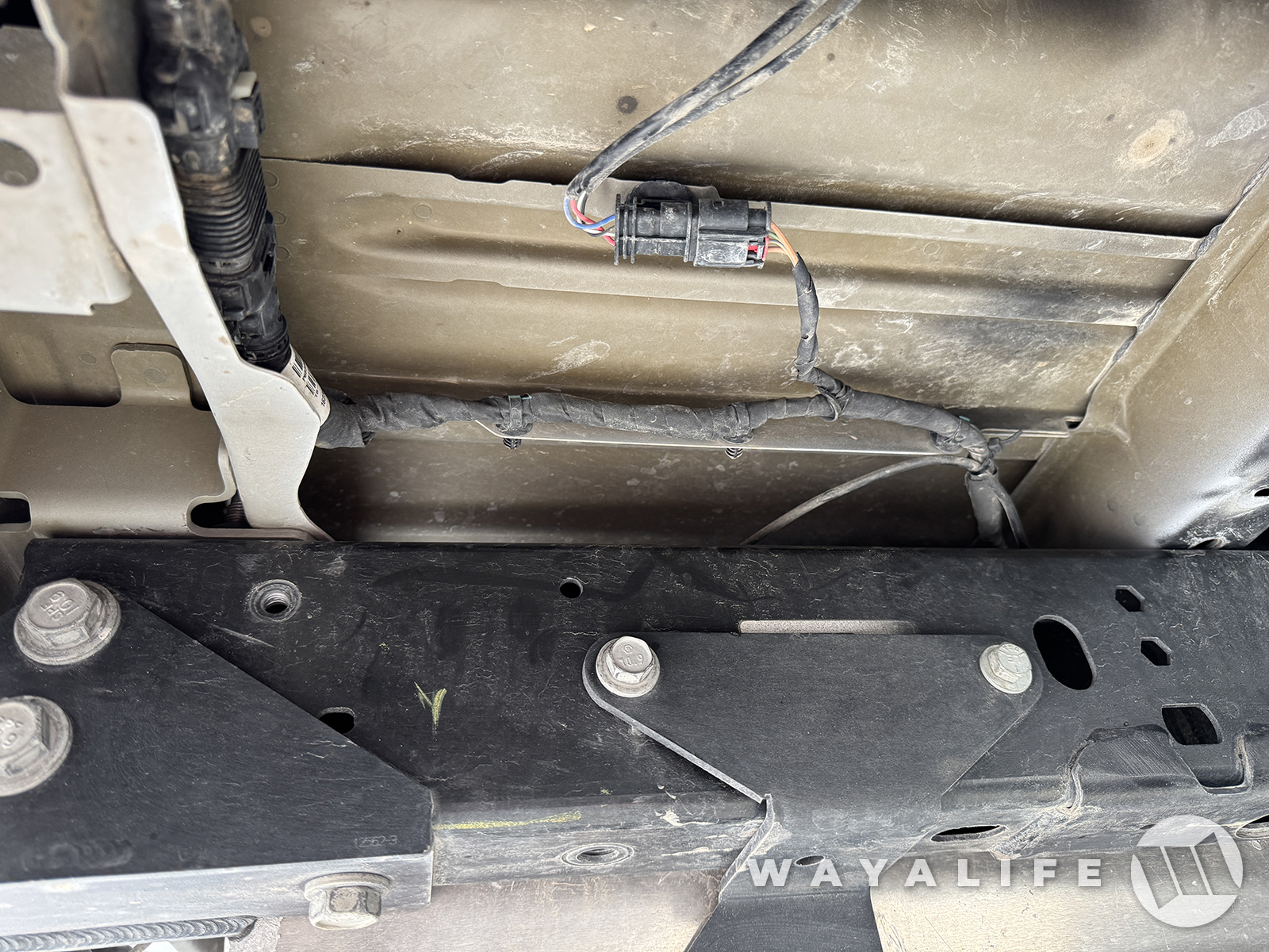

The one problem I just couldn't fix was the passenger side rear turn signal and as mentioned, I spent some time today tracing wires and focusing my attention in that corner. Of course, this is a highly modified area thanks to the aftermarket EVO gas tank and an even harder one to give a good look at. Here's what I was up against.
As you can see here, the wiring from the tail light goes long the frame rail and then tucks in and disappears behind it.
It took some effort to see and get to but after playing around with the wires I could reach and could clearly feel was just loosely sitting on top of the gas tank, I went for a drive and as I posted up earlier, things were notably better. While the problem did come back, it took a LOT longer before it happened.
With that knowledge in hand, I worked a lot harder to gather the loose wiring and zip tied it together and in place so that it wouldn't jiggle and or bounce around.
And, after going on a very long drive and purposefully driving over rough sections of road that would have totally triggered the turn signal and blind spot unavailable error... NOTHING happened!!!! This was clearly the source of my problem!!!
