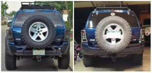

So other than license plate lights, it's all done. I decided to secure the latch pin with a stainless steel chain. Nothing says stainless and lightweight like a toilet pull chain that sits in water all day long. 4 bucks at ACE Hardware. I welded on a very small washer to hook it on to.
And here she is all done with the Rock Hard 4x4 license plate bracket. Everything fits tight, the hatch opens and closes normally, and it feels like it won't vibrate at all. Tomorrow's road test will confirm.
And here's a before and after:

Thanks. Lol, it definitely has its imperfections and I know where they all are, but that's what makes a jeep a jeep. I honestly rushed this thing more than I wanted to but I wouldn't change a thing. Glad to be done with it.
That came out awesome! You think that pin is strong enough tho? Seems like a decent amount of weight on the little guy
Nice work! Turned out great, I like how much closer it is, snug to the back. And also the angle to the back side. Very clean, very clean🥃

Nice work, looks real good and stock clean.
Thank you. Good to be done and I really like the fit. As far as the pin, I'm assuming you're referring to the latch pin. It's a Grade 8 clevis pin with 1/2" diameter. It goes through a 1/4" steel plate to latch. I would think it would be fine. As far as the hinge spindle, it's 1.25" diameter and designed for a DIY carrier with a 33 inch tire. I used it on the old carrier with a high lift jack and several years of offroad use. I still keep an eye on things always but I feel it should be ok.
Yea I was referring to the latching pin. Looked smaller in the pic which is why I was concerned lol. Should have known you would have picked something strong enough
