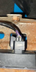

Did you do the switch to shut off the Govt yet? Ric is going to do his and was second guessing which wire it is. I sent Bill and Jerry the pic Ric sent me and it looks like a stick has more wires than a auto
I haven’t yet. I was gonna tear into it soon when I get around to pulling the hard top off.
Mine is a stick and this is what I have. From what I understand it’s the purple wire with light blue stripe. I’m guessing the one on the left?

That is correct. Splice the switch in there and you are good to go.
