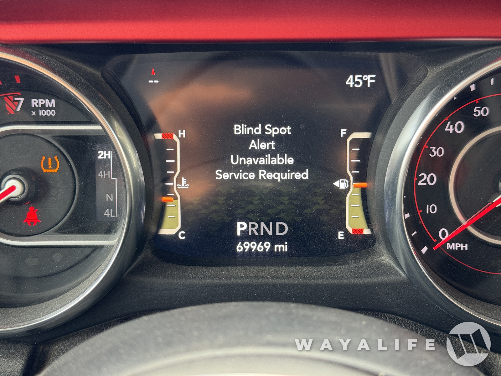

Jeep Gladiator Dash Electronics Flipping out

Just an update on things. Did some research and found that after disconnecting the battery for a long time, the Infotainment system can really get out of whack and do a lot of what I was seeing. I also found that it can take as much as 24 hours before things get back to normal. And, being that we needed to get back up to Carson City, I just wrapped things up and called it a day.
Yesterday, I started up the Gladiator and surprisingly, things were a bit better. Right off the bat, there was no weird pulsating sound coming from the subwoofer, the Infotainment system fired right up, no heater was on and I even had a rear back up cam again. Once on the road, a few things acted up again like the blind spot being disabled and the radio only kind of worked, steering wheel radio controls didn't work either and none of the center stack controls worked but at least, the Jeep drove and without other issues.
Now, here's the crazy part. The longer I drove, the more things came back to life - the more things became normal again. After about an hour or so, my radio worked, my climate controls worked, I no longer was getting blind spot errors or anything. Really weird stuff. However, when ever I stopped for gas or the like, a couple of things would act up again but just for a moment and each time, it was less and less. The only thing that's still not right is the right rear tail light is out error and that was the very first thing we saw when all this started. From about half way home on, I could hardly tell that we ever had a problem at all. Totally crazy!
