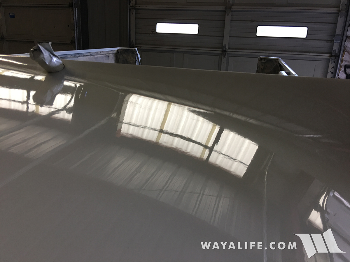

While Emma is looking "pretty good" with her new color, there's always room for improvement. Been spending long hours color sanding and buffing her clear coat and while I still have a long way to go, here's a couple of shots to show what a difference it makes.
Before with all kinds of orange peel and nibs...
After...
Before...
After...
Being that I'm doing all this by hand, it'll be a while before I finish but so far, I'm pretty happy with the results![]()

Eddie, I need to do that to my hood louver I color matched. What are you using for buffing, etc? Looks great![]()
What? Buffer! And here I thought you were doing it karate kid style! Mr Miyagi would be disappointed.Honestly, I don't know if you can do this on something like louvers. At least, I don't know if it'd be worth it especially being that the cost is pretty high just to get started and the louvers are going to tear your buffing pads apart. Assuming you painted them with a good 2-stage paint, the amount of control you'll need to keep the paint from burning will be really difficult too. That being said, I am using 3M pads and their Perfect-It compound and polishing system. This alone will set you back about $300 or so and you'd still need a good buffer with a low RPM setting.
