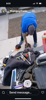

Was way overconfident in how much time it would take....

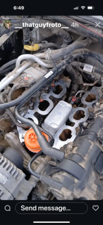

spark plugs and coils:
