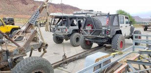

Well I did this today. 🤦*♂️ Spun the rear diff and broke my rear driveshaft. Broke the plug welds and diff spun. Tubes didnt move.

Doh! That sux big time. Fixable?
Yep quick and easy when you go to the right place. Moab Motorsports in Moab has done a few and it took him about an hr to roll it back down and weld the tubes and plug welds.
All about the leverage to rotate it back.
That’s crazy, it’s great to have the right guys around. Glad it all worked out
That's quite the tow truck.
Don’t they have to heat the diff housing up to weld the cast then let it cool really slow?
