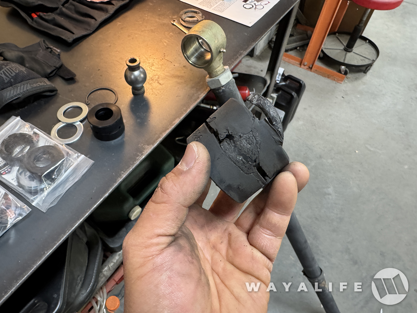

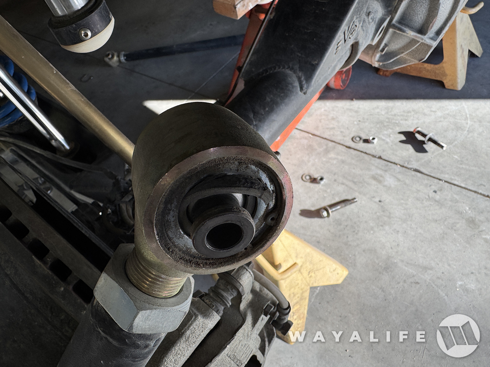

How many miles on those arms?The rear end on JAWS had been feeling kinda funny - like it had torque steer and or just a bit sloppy and for a while now. Anyway, I was looking at it in the rear view mirror yesterday and noticed that the whole thing was literally shifting over to passenger on acceleration and back to driver when decelerating. Needless to say, this is what the triangulated upper arm bushings looked like.

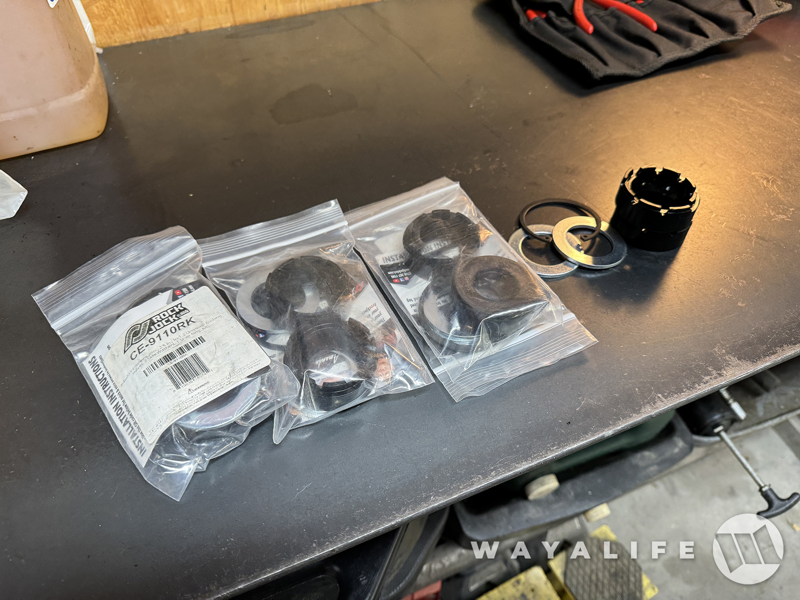

Fortunately, Summit is local to me and they had rebuild kits in stock.

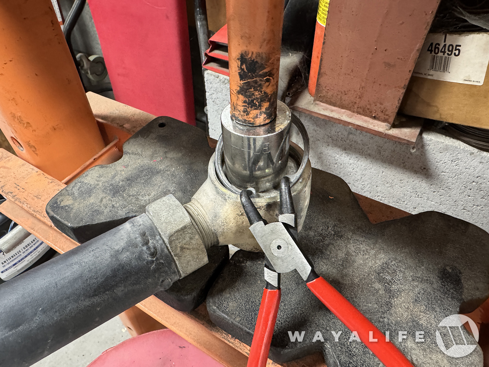

And, after a quick trip there and back, I spent the better part of the morning replacing them.
All 4 bushings were blown or in the process of being blown but one was so bad that two halves were welded together and had to be cut apart.
Anyway, thing rides great again![]()

So... I don't think there's more than 10k miles on them and really, that is way low. Normally, Johnny Joints will last a LOT longer and I'm almost embarrassed to say, I don't even remember when was the last time I rebuilt the ones on Moby. Something weird is going on - some kind of big time bind or something. I should note, our rear axle was always a little off center and today, I took the time to try and fix that. Both upper arms were exactly the same length coming off but when I put them back in with some correction, I ended up needing to make the passenger side arm a bit longer. Hoping this helps across the board and provides a longer term fix.
