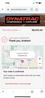

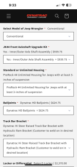

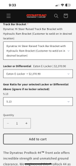

On a better note the wife told me to order my new wheels and front axle for the jeep! I just think she wants me to stop talking about it really.
