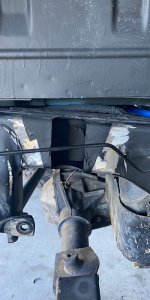

Finally got around to burning in my rear bumps.

Thanks guys. Really wasn’t hard just intimidating. Definitely have a lot to learn with welding, especially heat control. Slightly warped both cans burning the lower edges on which made for a lot of sanding to get the bumps into the cans.
Looks good Jeff
It feels good to do your own work, even when you have to overcome some problems as you learn👍👍
