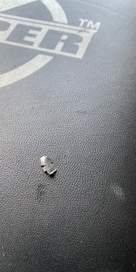

So I’ve finally gotten a chance to start going over the Jeep following our trip. First up was taking a look to see if I could find what happened while we were on Billings Canyon. I was making a climb and heard a loud pop from the rear end. Gave us pause as it Cleary sounded like an axle shaft but that seemed highly unlikely considering my build and that being far from the weakest link. Was definitely a three wheel bandit following that. However about half an obstacle later rear was locked and working “fine”. Lasted the remainder of that trail but apparently the rear stopped locking again while playing on Poughkeepsie. Opened up the diff this weekend and was optimistic when initially didn’t see anything.
Started cycling the locker and initially it was t engaging. After messing about and switch solenoids it started working (not as a result of the solenoid). Finally gave up and started cleaning up and that’s when I started finding goodies.

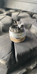

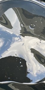

Those are all metal flames and chunks in the pan too.

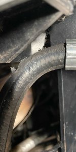

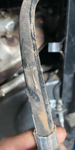

While swapping and adjusting I did find that the stupid battery tray is eating my reservoir lines but they are holding pressure fine. Time for a genesis tray.
Another option is to have longer hose made for the CO res and use Accutune weld on holders. The hoses are cheap and a lot of the NAPA stores will make them. We did this on mine & wrapped heat shield on the hoses.
I happen to know a guy that ended up with an extra set of the brackets somehow. Say the word and they're yours....

On the rear diff is it gears that are eating each other or is it the arb?
Just went through your full build thread and it looks awesome. Looking at build like this tends to keep me more motivated to do more on mine.
Not the gears. That I can see. It’s either the ARB has a failure or its remnants from the casting that are affecting the ARB. I swapped the fluids, brought some metal into my shop and they really were scratching their heads. Basically said run it till the problem is readily repeatable.
