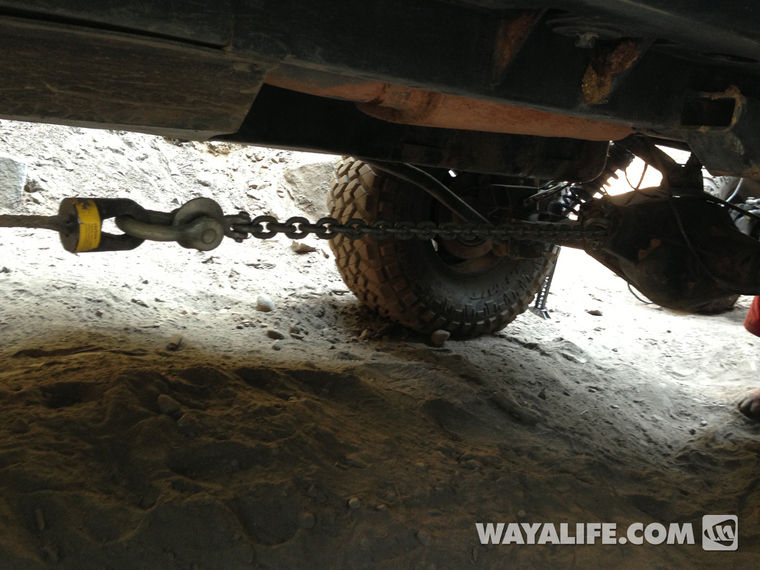

Yup, moving blanket is what I carry and it serves a lot of different purposes. A short chain is nice to have as it'll help give you recovery and trail fix options that you wouldn't otherwise have.
BTW, here is an example of how a short chain can help with a recovery. After one of the guys in our group broke his 3-link rear axle mount, there was nothing to keep the pinion from shooting straight up. Unfortunately, the yoke ended up jamming up against the gas tank skid and was near impossible to free. At first, we used the winch on the Jeep itself to hold it in place while a 2nd winch from behind tried pulling the yoke down but, that wasn't enough to do the job. The only way we were going to free it was by using a 3rd winch to pull it down from the front but there was no way to safely get a tow hook or d-ring secured safely to it. Fortunately, I had my short chain with me and it allowed me to do this...
As is the case with anything that can become a deadly projectile, it is important to be aware of it, take steps to mitigate the dangers and ONLY use it for slow, calculated pulling. NEVER uses things like this where hillbilly horsepower is required.
Again, I have not taken any courses and have not read any pamphlets so please, take what I say and show for whatever they are worth.

A chain and a D ring, Damn you're daring...:D

A chain and a D ring, Damn your daring...:D
Daring? I don't know, I think some would say that I'm just ignorant or flat out stupid. I'm sure if I had taken a course and read a pamphlet, I would have known of a better way to make this recovery possible. :crazyeyes:
I think this exact way, and I think that this is the major point that everyone on here keeps missing.
If something requires more than a simple tug, then in my opinion the winch needs to come out to keep things safe.
It's never good when someone needs to rev up the recovery rig and dump the clutch!
