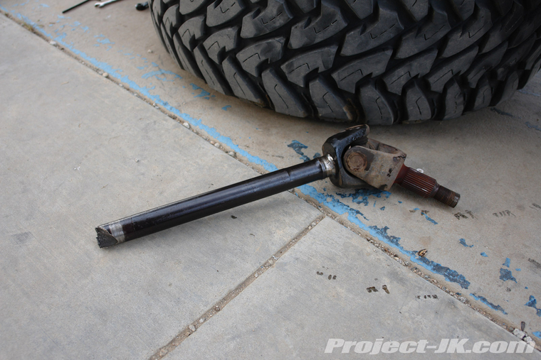

You sir, do a pretty thorough job at breaking shit. Hope to see you back on 4 wheels soon. Keep playing that hard and you're gonna need some tons.Carnage at crawl event hosted by my club. Was an expensive day. Lost the ujoint, then the axle shaft and then the ball joints. Was surrounded by great friends to help me out and get it back down to the staging area (using a log as a skid) and ready for a tow the following day.
Got replacement ball joints here tomorrow so I can get her back on the road. Contacted Jeremy about a new chromoly axle shaft so hopefully that’ll work out.

Yeah, they were. Splines were perfect so happy my gears are fine.Holy Crap... Factory Shafts?
Lol! I’m normally much more controlled snd careful, just wasn’t paying enough attention this time. Lessons learned for sure.You sir, do a pretty thorough job at breaking shit. Hope to see you back on 4 wheels soon. Keep playing that hard and you're gonna need some tons.
Its crazy how fast that shit can snowball if the joint goes.. kinda why I upgraded before I needed to.. saw a similar post years back and it scared me a little. Cool your splines are ok.. and you had help getting off the trail.Lol, that’s what I said!

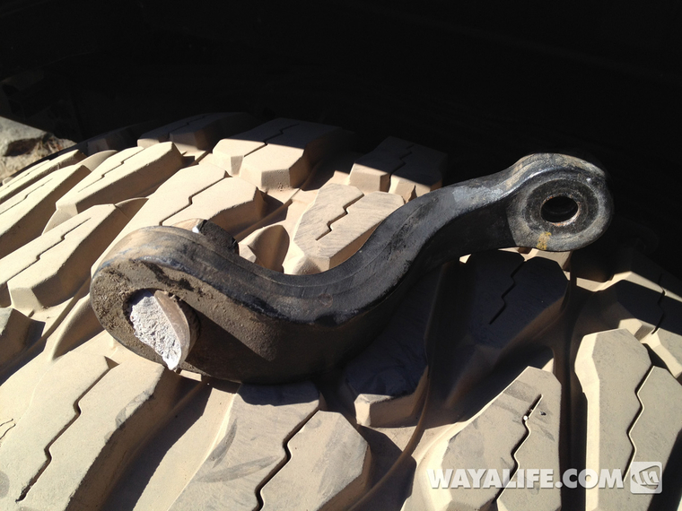

Probably one of the worst breaks you can have - a sector shaft, taken out on the Rubicon...

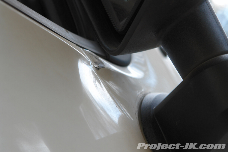

Kiss from a tree on the Dusy Ershim. As you can see, I wasn't the first to get the love tap and, I doubt I'll be the last...

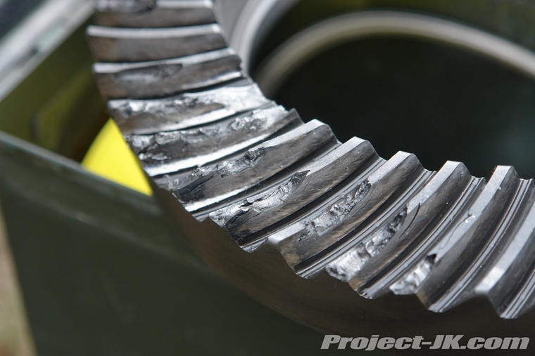

Blown out rear end also compliments of the Dusy Ershim. Should have known better than to run a 5.38 ring & pinion in a Dana 44 rear axle pushing 40x15.50's...

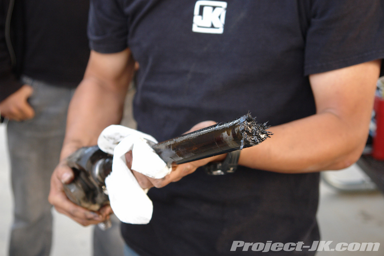

Here are some shots of a chromoly front dana 44 shaft after being played hard on for about a year...

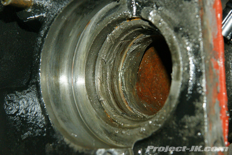

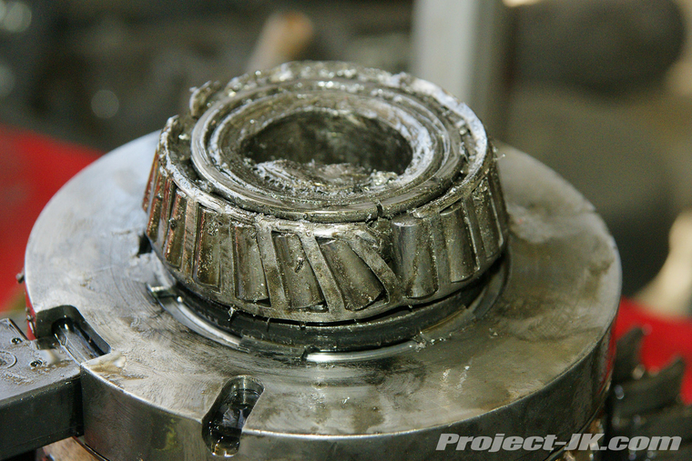

Sure would have been nice if the darn shaft had just broken at the U-joint. Here are a couple of shots of what it ended up doing to locker, bearings and housing...

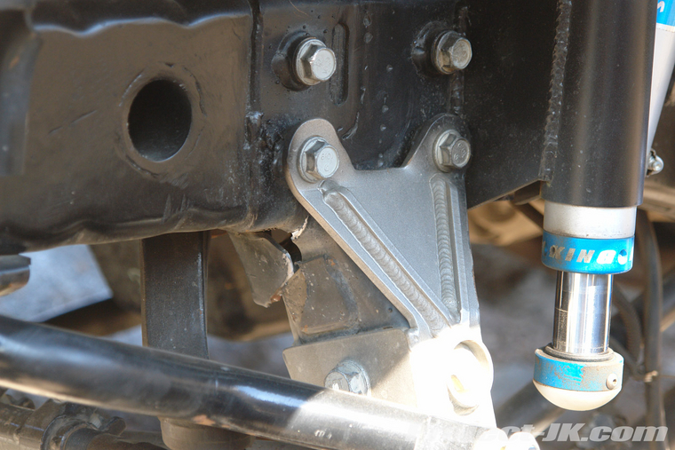

Broken front track bar mounts compliments of the Bronco Peak Connector...

Yep, it snowballed from a busted ujoint to axle shaft and then somehow the upper ball joint popped out which then jacked up the lower ball joint! I heard it pop and the Jeep down off the rock and the wheel assembly was laying nearly flat on the ground. The C and the ball joint seats are fine so I really don’t understand how it all just fell apart.lost a u-joint and the carnage dominoe'd to the ball joint?
did the knuckle fall off ?
I recall something about JL ball joint, knuckle design allowing something like this to happen

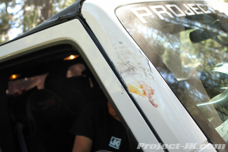

The scratch on the door looks really serious!Carnage at crawl event hosted by my club. Was an expensive day. Lost the ujoint, then the axle shaft and then the ball joints. Was surrounded by great friends to help me out and get it back down to the staging area (using a log as a skid) and ready for a tow the following day.

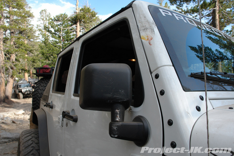

Lol, not as much as pushing in the B pillar by the hinge.The scratch on the door looks really serious!
Tree branch I believe. I didn’t hear or feel anything. My buddy stopped me and let me know I had a big dent. Might have to take a hammer to the peak at the top so I can install my Roll N Lock Tonneau.Damn. Tree or Rock?
