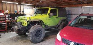

I kept thinking the front of my Jeep looked a bit saggy. Not sure if the plush rides settled or sagged a bit but I had a set of 3/4" spacers laying around so I threw the front set in today and I think it looks much better now. Honestly the next set of 3" plush rides that show up for sale I may jump on them. With how wide this thing is I think the extra height will look good and I can finally buy some longer rear shocks. Can't see a whole lot of difference in the pictures but it's definitely noticeable in person20200405_154216.jpg20200405_172925.jpg
