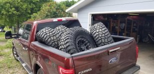

It's not really yours if you don't mount 'em yourself. 🙄🤣
There are a few things in life I'm 100% ok with paying someone else to do, mounting and balancing tires is one of those Haha.
It's all your fault anyways seeing you put on the 37s made me need them too!!!!
