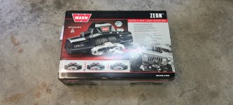

Lucked out today , Found a local vendor who had one Zeon 10s in stock. Ran out and nabbed it. Then my Baja Designs showed up. ( These suckers are bright for a fog light not sure if I can run them as a driving light) So a pretty busy day. 20210603_142429.jpg20210603_154315.jpg20210603_205715.jpg20210603_205722.jpg
Also my rear J.E.Reel 1350 and EVO Protek Long Arm Compatible cross member skid showed up a few days ago. Got my appointment set up for the 17th with ORE in AZ, Their going to do the LA install.
Lucked out today , Found a local vendor who had one Zeon 10s in stock. Ran out and nabbed it. Then my Baja Designs showed up. ( These suckers are bright for a fog light not sure if I can run them as a driving light) So a pretty busy day. View attachment 363734View attachment 363735View attachment 363736View attachment 363737
