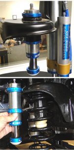

Anybody have the instructions for installing the front King Bump stops? I thought I had them, but I can't find them. :doh:

Hey Mike, I don't have any better pics but think it's just using the two lock rings/nuts to adjust the height and position of the air bump to match your factory bumps length. I'm sure there's a fancier way to do it but I'd just get the compressed length measurement and match that to your factory bump length and tighten the lock rings against the ends of the sleeve in the spring perch. You'll see it better when they show up. They're charged to 100#'s.

I think I remember that you have to cut the tube down, but then again if I could remember I wouldn't need instructions. :cheesy:
