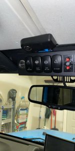

Sorry for the delays. I went cheap on my switch system and bought an Amazon Applootech switch. Few guys around me run them with no issues so I’m giving it a try. Everything wired up super easy and works like a charm.

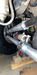

Also got my new 8” ram installed. Had to grind down my steer stops more to accommodate the longer ram. Similar to Bill, I will need to get new tabs welded to accommodate my set up. At full steer the ram hits the drag link. I’ve rotated moved and twisted it every which way but alas I gave up
And bolted it down until it goes to the shop for final tune and they can weld some tabs in a better location.

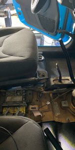

Also finally got my new ebrake cables delivered. wasn’t sure what to expect on this task but honestly
far easier than I thought. Hardest part was disconnecting all the seat wiring again to rip the center console out. Still need to figure out a better way to secure the cables to the control arms.

Only issue with new cables is it’s pulling uneven right now. Driver pulls further than passenger. Seems to be holding though
The evo long arms just have a small tab welded on them that you zip tie the cable to. I would get a bigger cable though. That little one will snap.
I’ll take a look but pretty sure the cable is the same diameter. The 14 bolt has a different connection and that is what I needed. Good eye though. I will definitely double check
