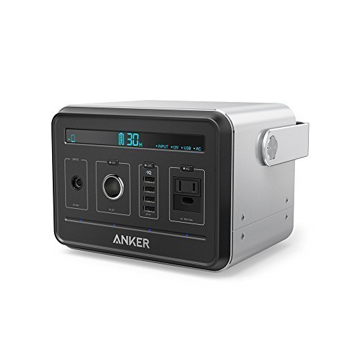

Saw this today, and thought of the Shark Tank: http://www.amazon.com/Anker-PowerHo...d=1460995721&sr=8-1&keywords=anker+powerhouse
Its basically a Lion version of the Goal Zero, and apparently also solar friendly, while being about 1/3 the weight. I see where one might want a goal zero instead, as they have been around, and the lead acid batteries are a known quantity, but this looks pretty cool in and of itself.
That looks pretty damn cool. Thanks for posting that up. :thumb: I wonder what the risk (if any) is of fire. Looks like a well-respected company that has been in the business for a while. I am all for innovation and competition with this stuff. Maybe it will bring prices down a bit.
And yes, the goal zero yeti 400 is HEAVY!
I have a couple of Anker products and have had no issues (smaller battery banks), but I would assume (we know how that goes...) that they have a fairly decent anti-overcharge and discharge circuits built in to help alleviate a large part of the risk - but fire would be the biggest concern for me as well.
My guess is GoalZero will have to start offering Lion soon as well, and I wouldnt be surprised if some more didnt come to market as well. Maybe a simple battery upgrade for current owners, and with the size capability, since the size is already set with the current build, maybe it would make it a Yeti600 or something. Then a smaller Yeti400...
I wonder if the battery is replaceable. I know that I can replace the battery in my Yeti once it takes a crap.
