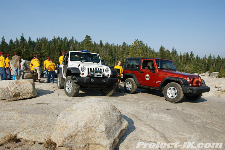

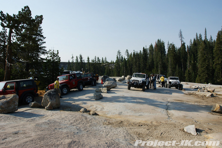

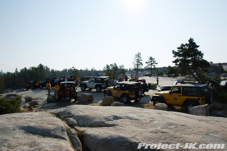

BTW, here's a shot I took a few years back of a Jeep Jamboree USA for forigners run on the Rubicon Trail. All the JK's were provided for the participants and were just 2-door Sports with factory street tires, no lift and no rocker guards. They did need a lot of help, were beat to all hell and took a long time getting through but, they did do it...
