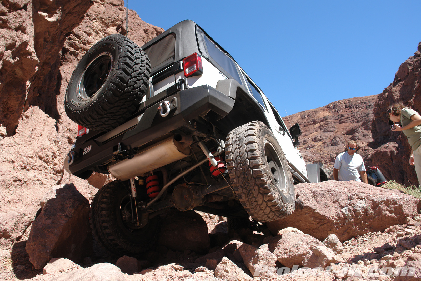

Holy crap, I never knew Moby had air bags! Must have been a short while running them. Did you suffer a from a puncture?
Or just wasnt what you were wanting when wheeling/driving?
LOL!! At times, it's even hard for me to believe that Moby is over 10 years old. Over those 10 years, we have run him in a myriad of configurations from stock to multiple 3", 4", short arm and long arm lifts and all before we got him up on coil overs and then upgraded from that to DTD's. We ran air bags back in the day because we always carry a ton of gear and were really heavy in the rear end. This caused substantial sagging and I used the air bags to help make up the difference. At the time, it was the only thing I could try as there wasn't much in the way of aftermarket products for the JK.
I have always wondered, do these limit flex at all?
Yes, they do a bit but not as much as much as you'd think. When off roading, you'd run them at a very low psi and they will squash down quite a bit. The bigger problem is that your ride quality will be compromised - like running really stiff springs. They're cheap and they work but I personally wouldn't recommend them.
Eddie pretty much has it. Lower the PSI to almost nothing when off-roading and they won't limit it too much. They do increase the stiffness in rebound in the rear no doubt, but when carrying 1000lbs, I'll take the trade off. it may not be the perfect solution, but for running coils and if you carry a lot of weight frequently, they are a cheap and effective solution vs $2K for coilovers in the rear.
