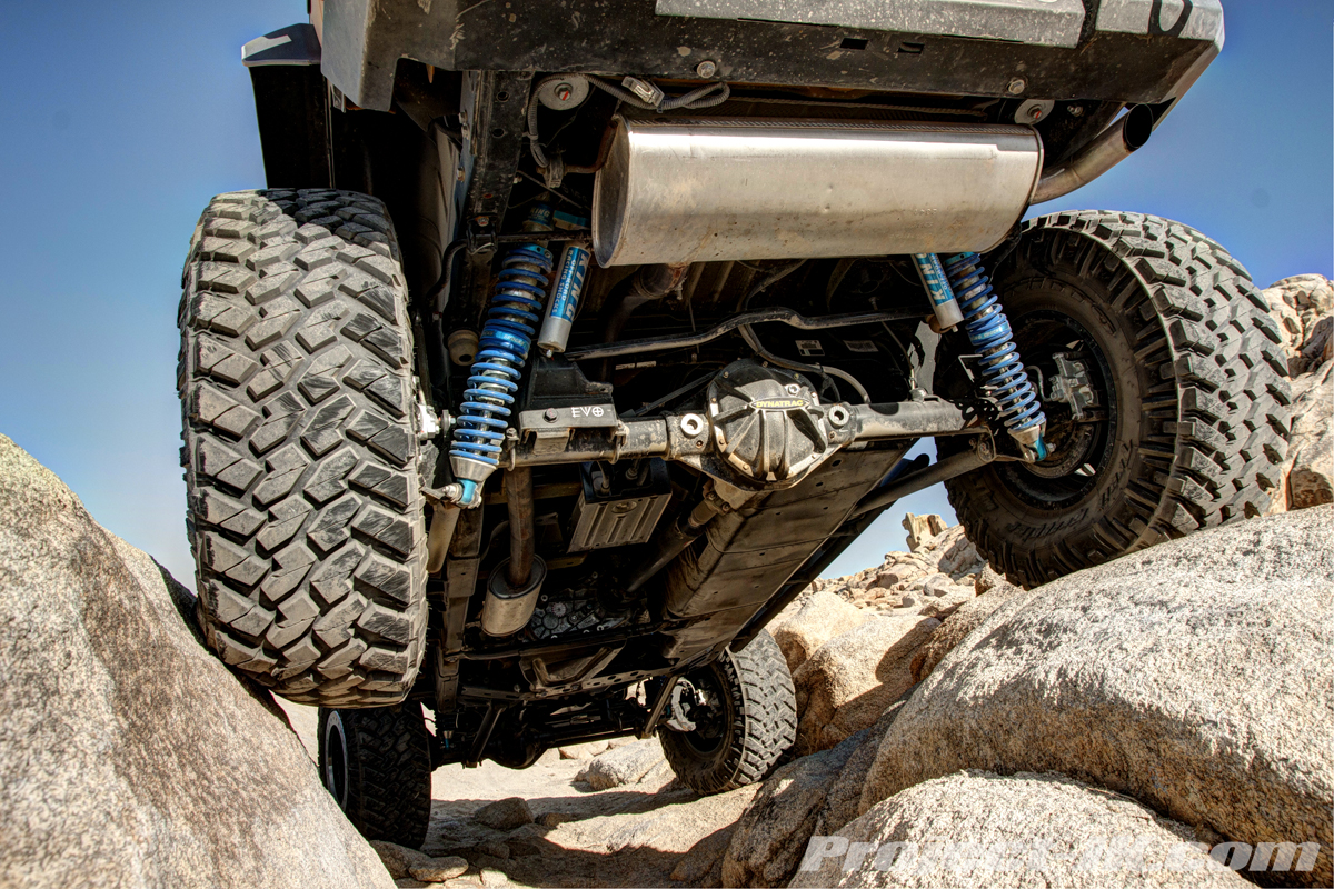

I didn't use Kings but I had to clearance mine for the Rez hose...easy to do.
I didn't like the Rez's where they were so I welded a tube across the frame to mount them to.
If it were me, I might want to rethink your exhaust dump. As it look in your photo, your driver side coil over reservoir is gonna heat up quite a bit and that'd be a bit self-defeating.

My thought is exactly with both Eddie and 2011jk... Looking up at mine, the end of the kings is massive and especially with how the resi hose is clocked it's going to be the issue.
I was worried about that but I've checked it many times and it wasn't a issue.
Its moot as everything is cut off and being redone.
