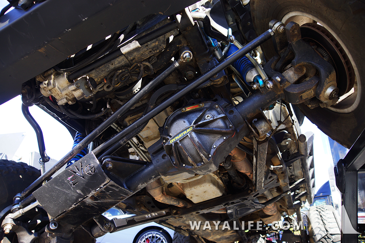

That is where I moved my ram to also. BUT, the cheap tie rod bent all the way in and still crunched the ram and fittings.
That's a pretty slick looking setup. The EVO skid, and are those the EVO high steer kit tie rod and draglink mounted in the lower positions with heims?
That's not the Dynatrac tie rod. That's something nicer looking, but with heims?

The bottom of the tie rod sits 1.5 to 2" higher than the top of the axle tubes... and at that height it can hit the frame at full stuff, which is why some people get the frame notched. How is that possibly too low?
And if you are referring to the ram, it's mounted on the high side of the axle tube, on 40s that puts the skid about 17" off the ground.
How much higher could these components possibly be mounted?
For reference, here is a purpose built jimmys buggy with full hydro used for ultra 4 racing, and surprisingly it doesn't look to be sitting and higher that the tie rod on a high steer hydro assist setup
SDG I get what your saying. Using your setup the way to raise the ram would be to flip it and mount it to the tie rod. If you did this you could raise the ram. Either way I'll be going with a double sheer set of arms.
