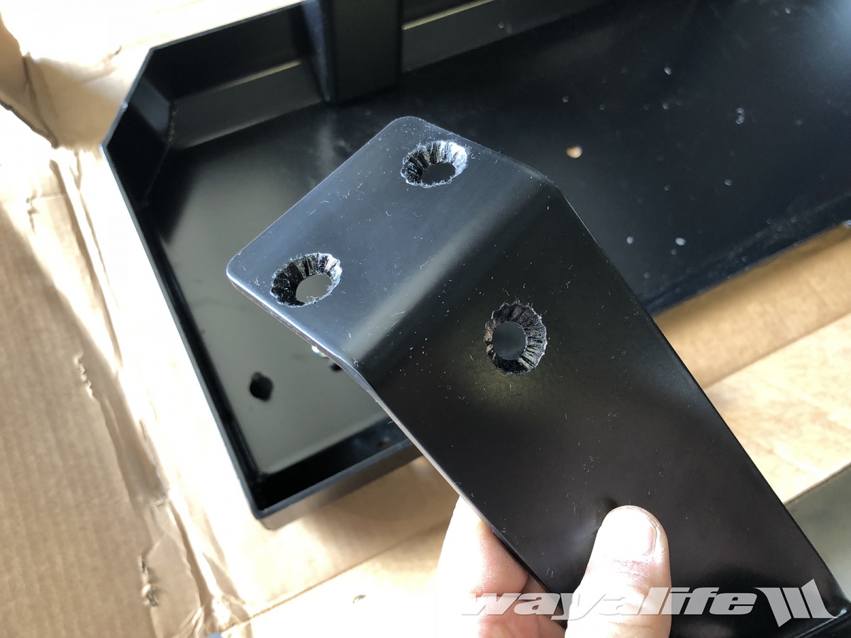

Not sure what happened here but I'm pretty sure even the instructions showed this bracket as having tapered holes for the tapered bolts.
Maybe not the prettiest fix but as luck would have it, I had a tapered bit and was able to address this problem. With a little paint, it doesn't look too bad.

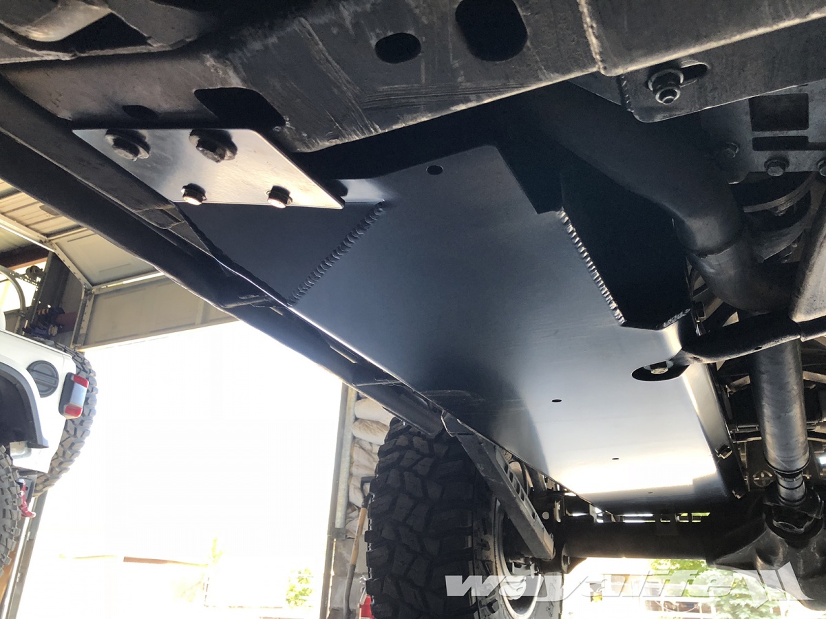

I don't know if it had something to do with Moby's gas tank or tolerances in the manufacturing of the skid plate but there were 2 bolts that were near impossible to install. Everything else went it fine and for a time, I thought I'd be done in minutes but ended up wrestling with this thing for a couple of hours. Anyway, when all was said and done, this is what the Synergy skid plate looks like installed.
