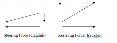

Not sure if this helps but the way I think of it is that when you steer the draglink pushes or pulls on your steering knuckle. The portion of this force that turns the knuckle (and subsequently the vehicle) is only the part of the force in the horizontal direction so having your draglink as close to horizontal as practically possible is useful for getting the most out of your steering assembly with the least amount of stress on your steering components.
Your trackbar connects the frame to the axle and keeps your axle centered under the vehicle. To do this it resists the force from the draglink on the knuckle along the center of the axle so that you actually turn the knuckle instead of just shifting the frame sideways (think pushing on the front and holding the center in place). If the trackbar and draglink are not parallel then the trackbar will not resist the force from the draglink in the same direction leaving unresolved forces which can cause steering issues. I tried to draw out an exaggerated example below. I am a nerd at heart so that’s how I understand, hope it helps.
