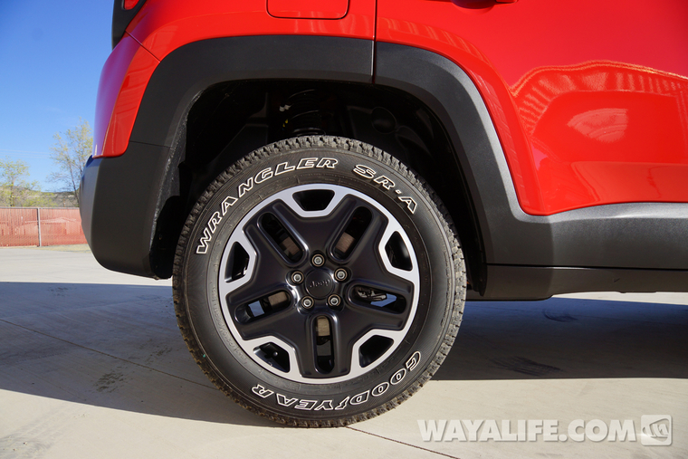

Even though we bought Renny, our 2015 Jeep Renegade Trailhawk back in February, we hadn't been able to do to much to it if only because there just hasn't been much of anything available for it. That is of course, not up until now anyway. Fortunately for us, Daystar has embraced the Renegade as a real Jeep just like we have and they've started to develop some well needed products for it including a great 1.5" spacer lift. With this lift, you can effectively run a tire that is about 2" taller than what comes from the factory on a Sport, Latitude or Limited and about a 1" taller or so on a factory Trailhawk. For our purposes, we were able to go from a 215/65R17 Goodyear Wrangler SR-A to a 225/75R16 Cooper Discoverer STT Pro mud terrain tire (with the help of new 16" Chevy HHR Wheels and 1.25" wheel spacers) with just a touch of rubbing of the fender liner at a 3/4 turn of the steering wheel. Anyway, here are some first pics of what our Jeep Renegade Trailhawk now looks like, I hope you enjoy

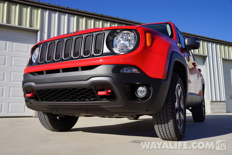

First off, this is a shot of what our Renegade looked like right after we brought it home.

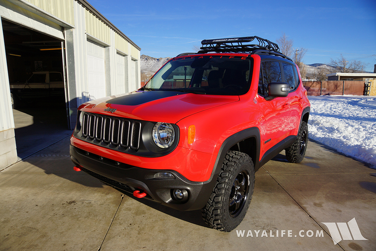

And, this is what it looks like now.
Here are more pics to get you a better idea of just how much nicer a Jeep Renegade can look with just a little bit of help.
Here are a few shots that will help you to see just how much nicer a Jeep Renegade can look with an aggressive set of tires and a wider stance (thanks to the help of 1.25" wheel spacers). First, here's a before shot.

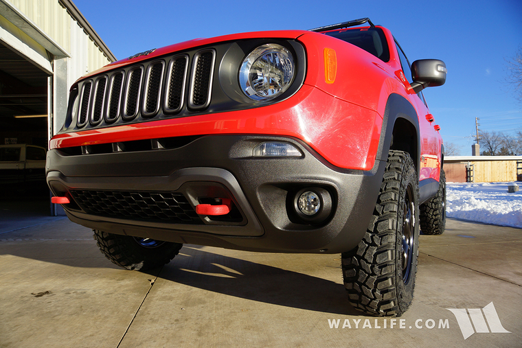

And now, here's what our Renegade looks like now.

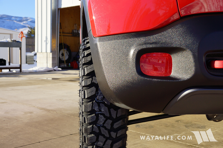

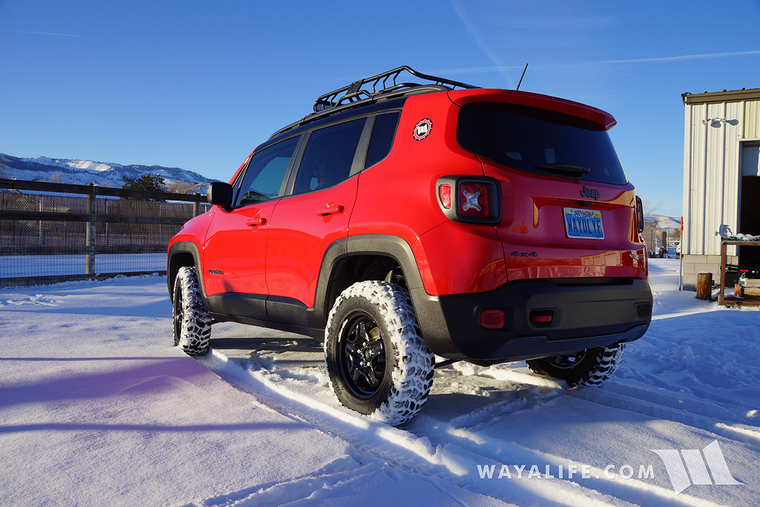

A couple of shots from the back. First, what it used to look like.
What it looks like now.

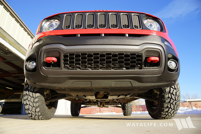

Here's a shot that will help to show just how much more ground clearance an additional 2" of lift (1.5" lift + 0.5" of extra tire lift) will give you.
A few more low shots so that you can get a better look at the stance and our new Cooper Discoverer STT Pro tires mounted on 16" Chevy HHR steel wheels.

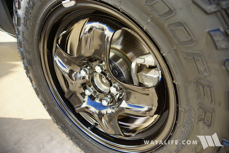

Close up shot of the 16" Chevy HHR Wheel with a 1.25" wheel spacer to help clear the brake caliper and give a nice stance.

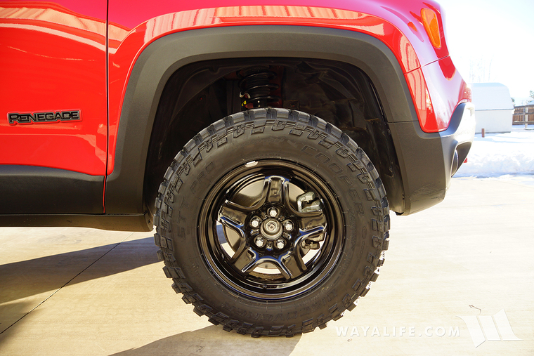

Here's a before shot of what the factory wheels looked like under the front fender of the Renegade Trailhawk.
And here's what it looks like now.
Again, this is what the rear looked like from the factory.

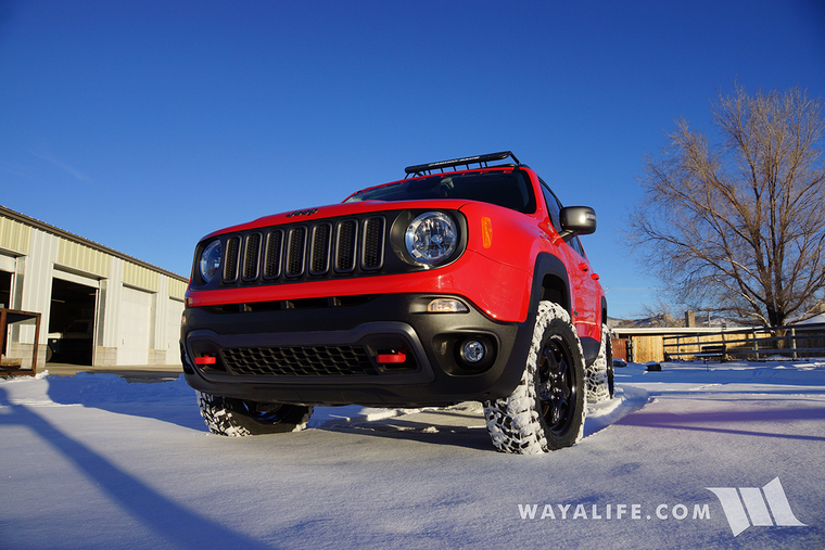

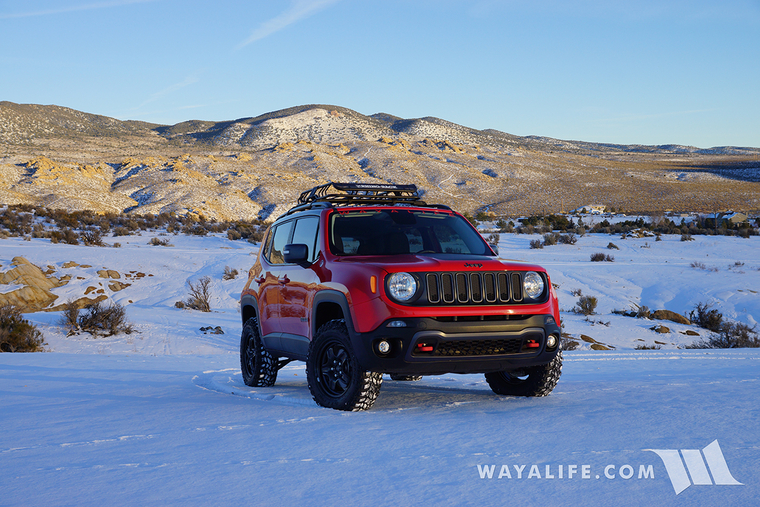

And finally, here are some snow play shots that we took out on our maiden voyage with the new lift and tires installed.
