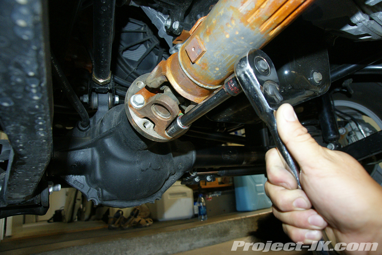

On 2012 and newer model JK's, your front drive shaft will make contact with the exhaust cross over if your front axle is allowed to droop too much. This will not be an issue if you just stick with the factory shocks.

This write-up was written for 2007-10 model JK's and the removal of the automatic transmission skid plate would have provided enough clearance of the front drive shaft to make the installation easy. The new placement of the 2012-up exhaust crossover will get in the way of your drive shaft regardless if you have an automatic or manual and disconnecting it from the front axle should be done to all for full droop. There are only 4 bolts to remove and a 15mm socket is all that you need. This is a much easier and safer way to go than to use a spring compressor.
