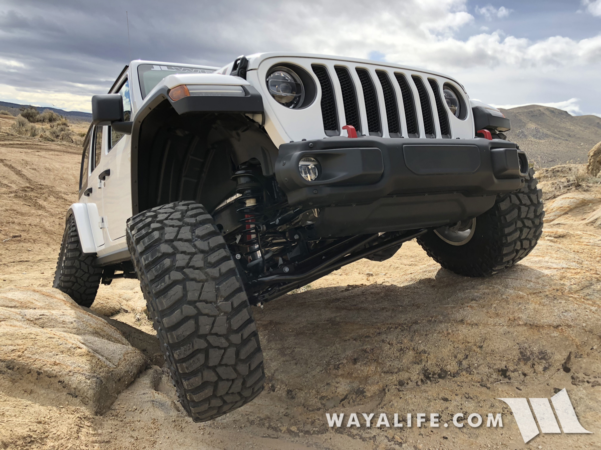

While ramping a Jeep or lifting it from one corner with a forklift can give you an idea of things, the best way to see just how much flex it really has is to get it twisted up. The opposing flex will force the axles to mash into the bump stops and drop the opposite side down to a full droop. Unfortunately for us, we were already hearing a good amount of rubbing well before we could work our way up into our testing obstacle but, here we went anyway. For our first test - driver side front up and turned to the left.
As you can see here, the front jounce stop or bump stop is fully compressed.
In spite of how this pic may look, there is no rubbing of the tire on the driver side fender liner, coil perch, frame rail or other wise that we could see on the driver side and with the wheels turned to the left.

Turning to the right to check for any rubbing or clearance issues.
Here you can see that the tires clear the front bumper and grill.
Amazingly, the 13.50 wide Cooper STT Pros tuck up and under the fender as well but then, a lot of this has to do with the 4.75" of back spacing that the KMC XD231's have.

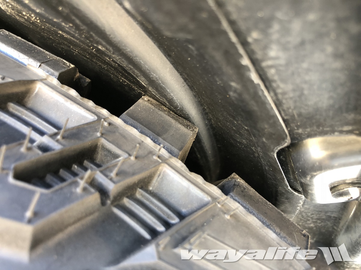

The bigger problem we found was that the lip of the main fender liner was catching on the tire lugs and getting pulled up. In fact, you can see that a push tab had already gotten pulled out. This was clearly the source of most of what we were hearing.

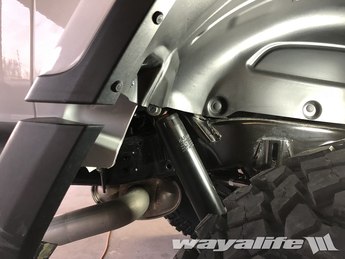

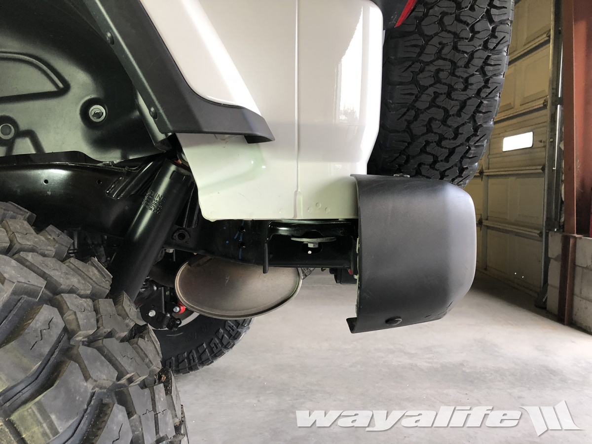

Back at the shop and ready to get our fender rub fixed, I started out by removing the lower liner that covers the bumper. On the driver side rear wheel well, this is where we were seeing most of our rubbing and an 8mm socket and 3 screws removed later, this is what we were looking at.
Again, using an 8mm socket to remove 3 more screws, this is what the bumper looks like without it's plastic end cap.
Using a 16mm socket, I then removed the lower liner bracket with the hope that would clean the look of things a bit. Here's a few shots of what the rear end looks like with just the steel bumper installed.
Moving over to the fender liner itself, I used a heat gun to help me reshape the embossing and concave it out of the way.
That ought to do it!
Not super thrilled with how the bumper was looking, Cindy and I decided to reinstall just the plastic end cap.
