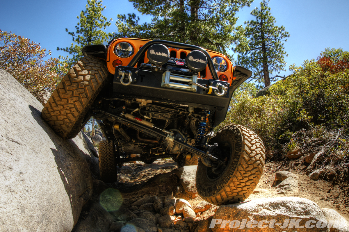

I have set the weight of the jeep on LODs skid plate paired with the signature series shorty front bumper while wheeling more than once.... and had the jeep sitting on just the roller fair lead on one occasion... here is what it looks like since the last time out wheeling *before touching up the paint
IMO, I'm not "Hard" on the throttle when wheeling, but I do take the challenging lines and use my equipment to the max of my ability. Take from that what you will, but I would not hesitate to purchase the quarter pounder or the LOD. IMO they are apples to apples as far as protection goes. My sole reason for going with LOD was appearance (I Showed both options to the wife and let her choose) :thumb:
