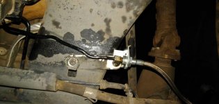

Doesn't seem right to me not sure what I'm missingView attachment 336486
Sent from my LM-G710VM using WAYALIFE mobile app
Looks like you straightened out the rigid line somehow. Also the new steel braided line should go behind the shock. Here’s my driver side.
Edit: was your Jeep lifted already before you got it? Looks like you have a drop bracket on your brake line that shouldn’t be there from factory.
