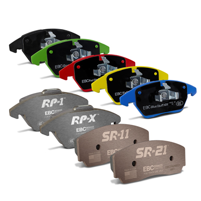

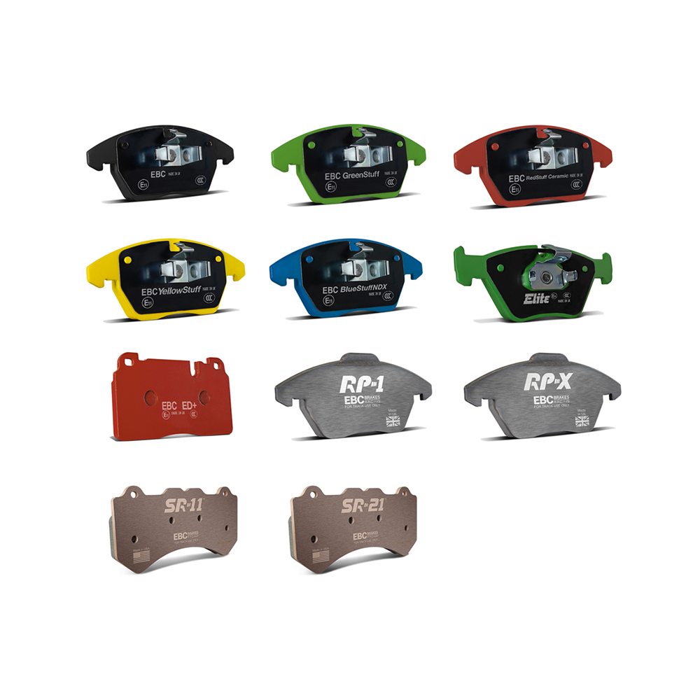

I recall them being red.
Looks like the "red" are the low dust ceramics.
I ended up placing an order for the "green" through Autozone. BTW - they have 20% off promo for home shipping with a minimum purchase of $120
I have another brand big brake kit but I’ve had really great results with EBC heavy duty orange pads. I ran these on the stock rotors with good results
