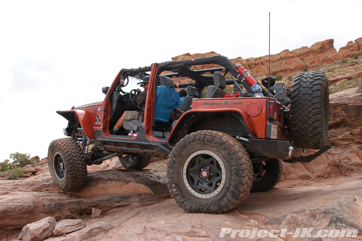

Correct. I have the new style Evo now that mounts to the tailgate. I was concerned about using it with a 40" tire and tweaking the tailgate if I bottom the spare out on a ledge. What do you think? Should I go to the original style like you have with corners or am I over thinking it?
Honestly, it's a legitimate concern but one that doesn't seem to bother Mel. He's running a 40" spare on Spicy Chicken and using the tailgate tire carrier he makes. I don't know where you go out to play but even in a place like Moab, good spotting can go a long way. Of course, if you'd still like to address it, you might want to consider having a hitch stinger made. I used to run one back in the day just for this very concern. It's cheap and works well - a much better solution than going spare-less or carrying one inside.

Hmm - I'm at 4 inches of lift with 5" of up-travel and it's going to take a LOT of trimming to clear my 40's.
I'll see if I can find a better pic but here's what I'm talking about.

Yeah, shoot. I'm not crazy about the stinger, but have some left over 2x2x.250 laying around. I put my tailgate mounted carrier for sale and have a good 8 weeks before my axles even ship, so it's not an immediate problem, but one I want to work out before Moab this winter.
