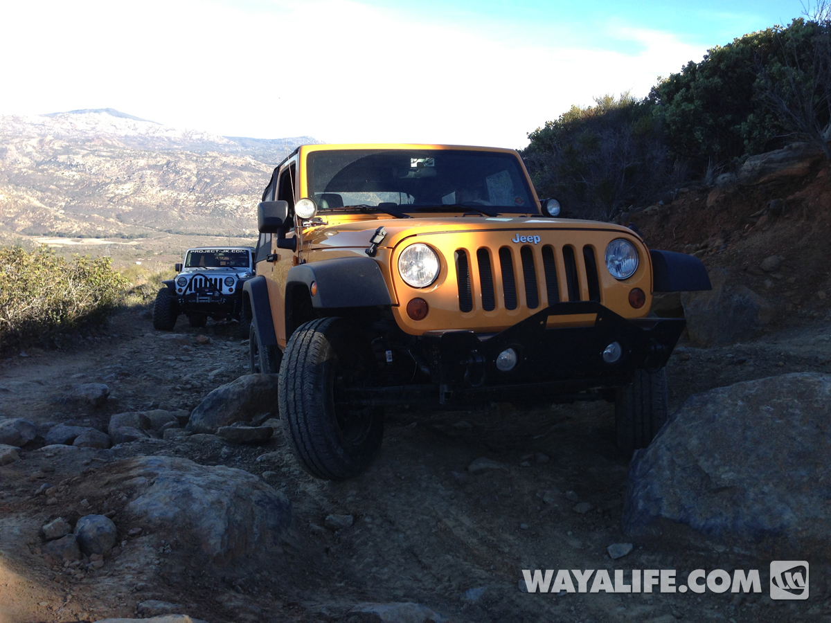

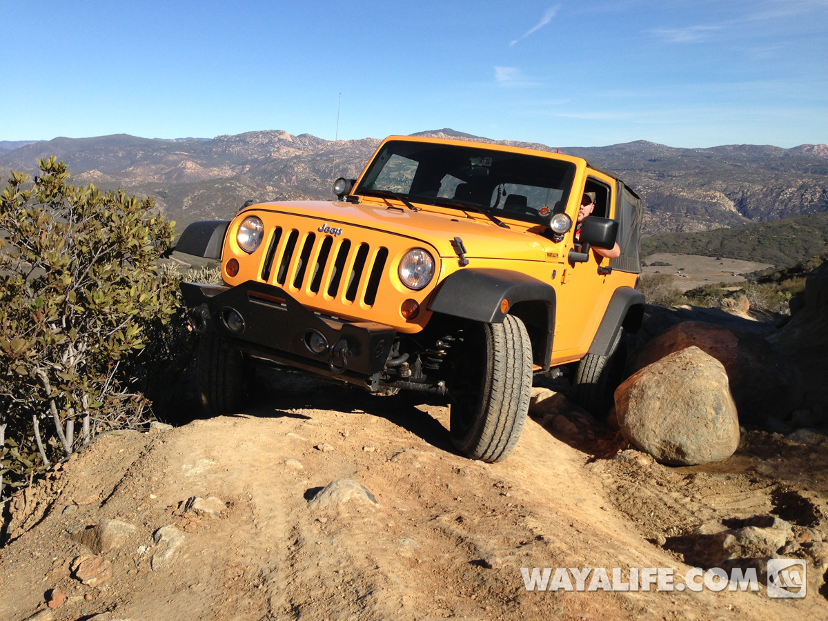

I wheeled my two door for 8 years with no skids. The trans crossmember looked like a pretzel. Never touched my oil pan once. Most people doing damage don’t know how to drive.
Had to dig these up. I think you had just graduated from Highschool or something LOL :ROFLMAO:
