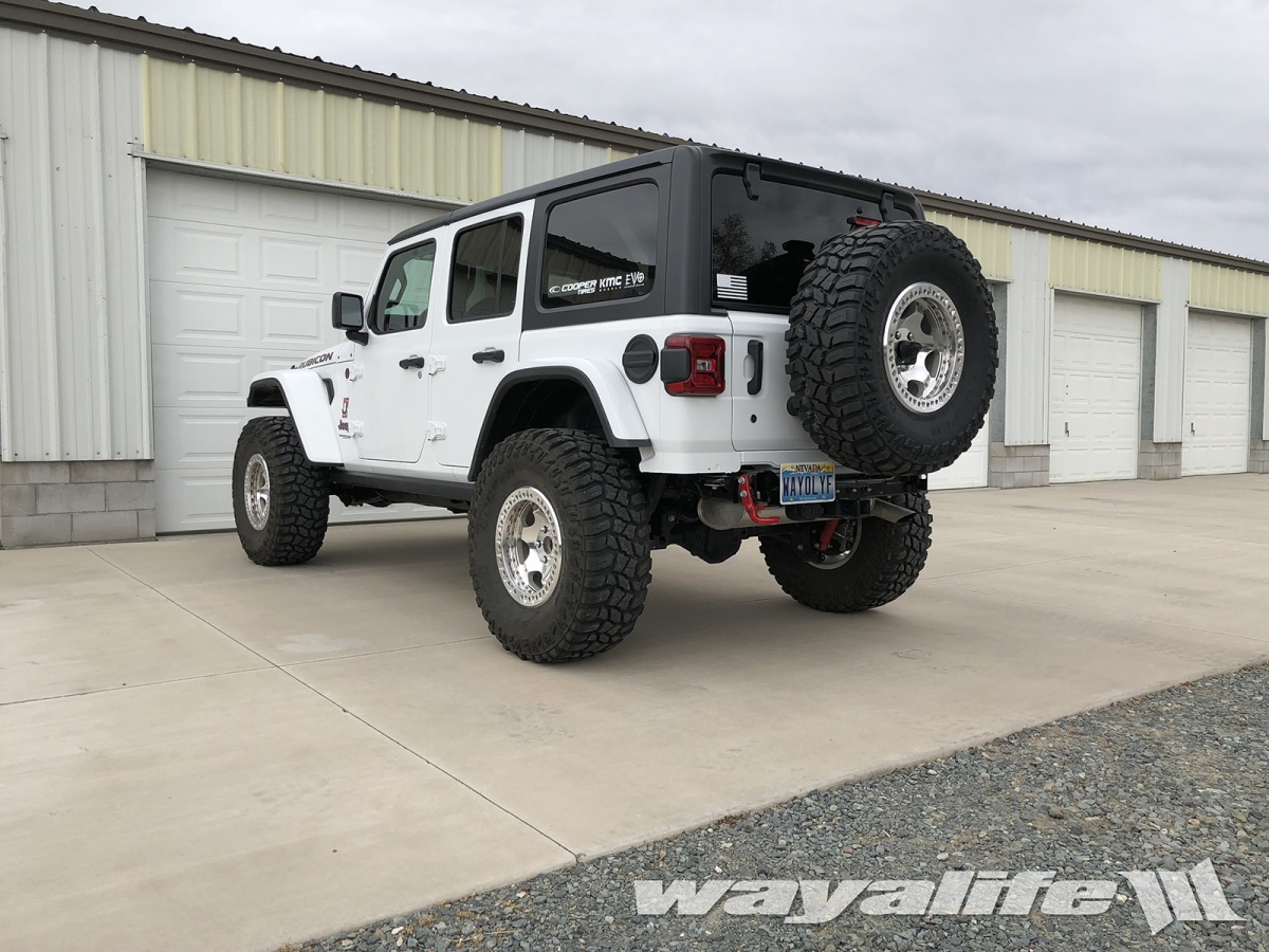

And that's all there is to it! You now have your license plate mounted onto the rear cross member of your Jeep JL Wrangler and with enough room to install frame rail D-ring mounts once they become available. Here are a few pics of what everything will look like once everything is installed.

Good home made mod. The JL doesn’t look bad without the bumper. Just needs a EVO frame cover and d ring mounts.

Looks great!! [emoji106] no more body damage
At least not from the bumper :crazyeyes:
Thanks! We're definitely wanting a set of frame rail d-ring mounts :yup:
That looks great! Easy and gets rid of the big rear bumper.
Thank you and yes, finally got to get rid of that nasty big ass.
I was skeptical at first. Turned out pretty damn good.
LOL!! It really doesn't look too shabby does it. Thing is, this is essentially how all Jeeps came way back in the day. :yup:

That came out really good. Thanks for posting up. [emoji106] The way it steps off using the stock bumper bracket might leave room even with something like the eventual EVO rear facia.
Yup, should work just fine with an EVO fascia. Hell, be nicer if they offered some kind of provision for the license plate though :)
Looks much better without the bumper!
Nice job
Thanks! Much happier without that nasty and damaging thing :crazyeyes:
