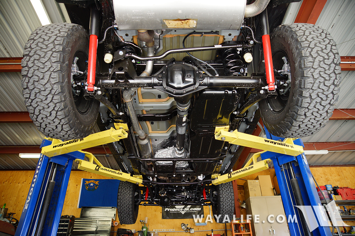

REAR END
Okay, these first set of shots are all from the rear end and document in detail, some of components you'll most likely be working with there when lifting your JL Wrangler. First up, a total overview.
A couple of shots that give you a better look at the JL Wrangler muffler and its all new Dana M220 rear axle.
A side shot of the muffler.
While similar to a Dana 44, the shape of the Dana M200 is definitely new and unique to it.
This passenger side 3/4 shot of the rear end shows how the rear shocks are now mounted on the outside of the frame rails. A nice improvement over the JK setup.
It's a little hard to see but here's a closer shot of where the shock is mounted on the frame rail. Nice thing is, it now uses a through bolt instead of a bar pin.
Here's a closer look at the passenger side rear coil, track bar frame mount, bump stop, shock and sway bar.
A view looking across the length of the JL Wrangler rear track bar. As you can see, it's bigger, beefier and shaped differently than the old JK.
And, this is the driver side so that you can see the bigger, beefier and raised axle side track bar mount.
3/4 shot of the rear from the driver side.
We ordered our JL Wrangler with the tow package and taking a step back, you can see what the hitch receiver looks like mounted under the rear bumper.
Here you can see that unlike the JK before, the JL Wrangler tow package comes with a weatherproof, standard 7-Pole and 4-Pole Trailer Connector Socket.
Being that we do have a Rubicon, it did come with a nice red J-hook style tow hook mounted on the driver side frame rail.

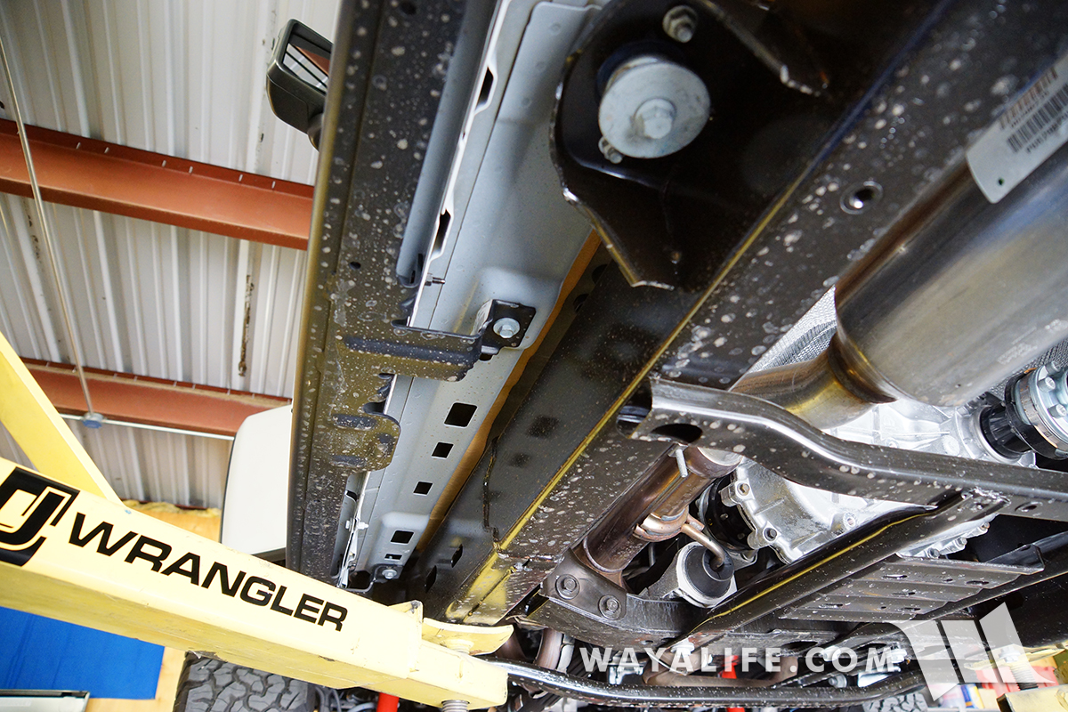

Looking up at a JL Wrangler, 3.6L V6 Pentastar Engine. As you can see, it looks completely different from a 3.6L in a JK and the oil pan is even more out of the way and smaller too!
More than the tiny oil pan, the reason why I'd want to install some kind of armor here is to protect the transmission cooler lines from renegade branches and roots on the trail.
Here's a shot of the motor mount.
