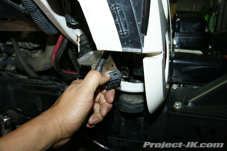

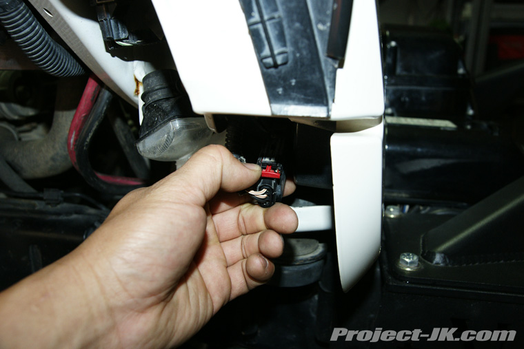

2. Look behind the front grille, locate the wiring harness attached to the indicator lights and unlock the plug by sliding out the red tab as shown in this pic.
3. Press the release tab on the end of the wiring harness plug and then pull it out.

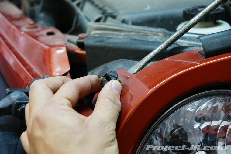

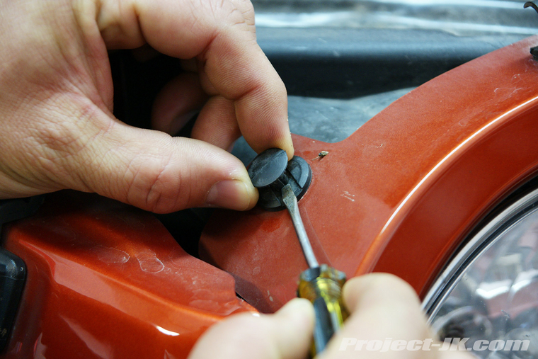

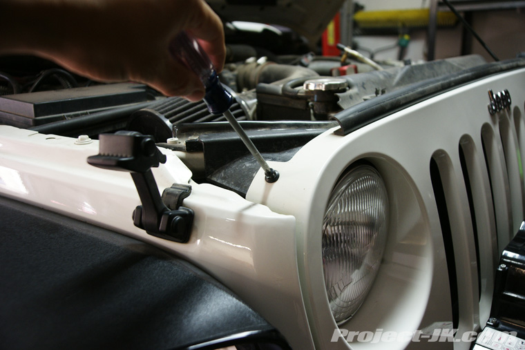

5. If you have a newer JK, use a small flathead screwdriver to unlock the retaining tabs on top of grill by lifting up the pin in the center as shown in this pic.

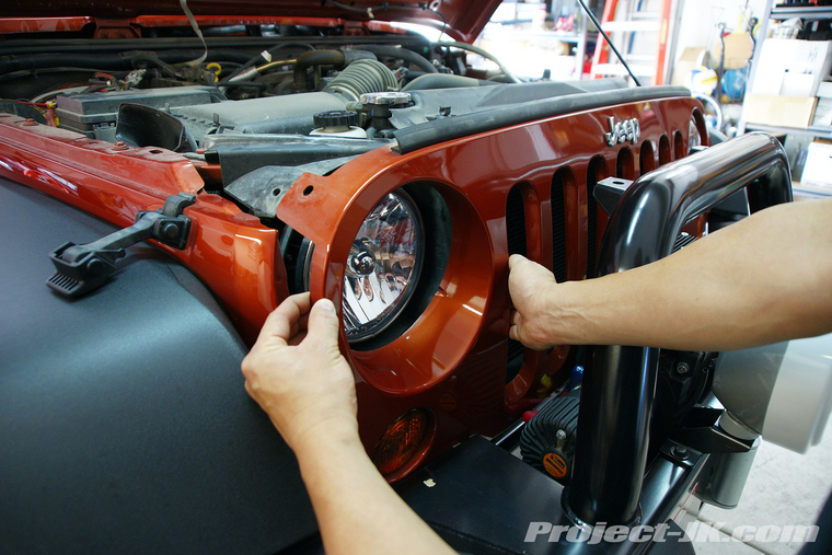

6. Once the retaining tabs have been unlocked or unscrewed, use a flathead screwdriver to pry up the back side of the grill just enough to pop them out.
7. Carefully pull on your Jeep JK Wrangler’s grille until it breaks free of the retaining clips.

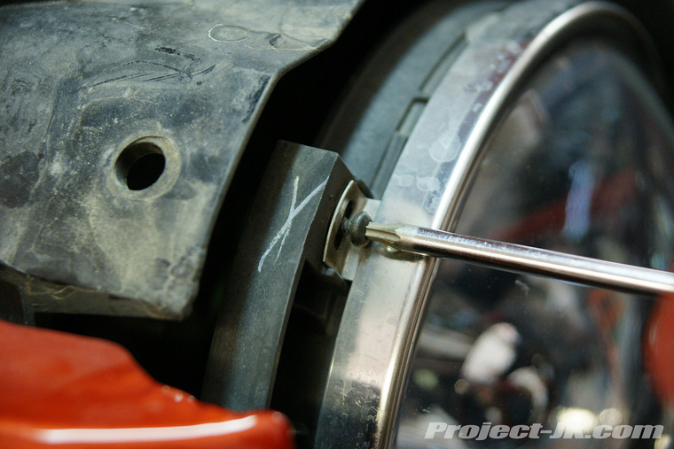

8. Using a Torx T-15 driver, remove the 4 retaining ring screws securing your factory headlights in place.

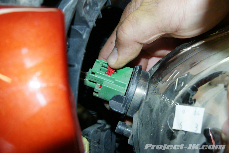

9. Pull the headlight out a bit, locate the wiring harness attached to the back of it and then unlock the plug by sliding out the red tab as shown in this pic.

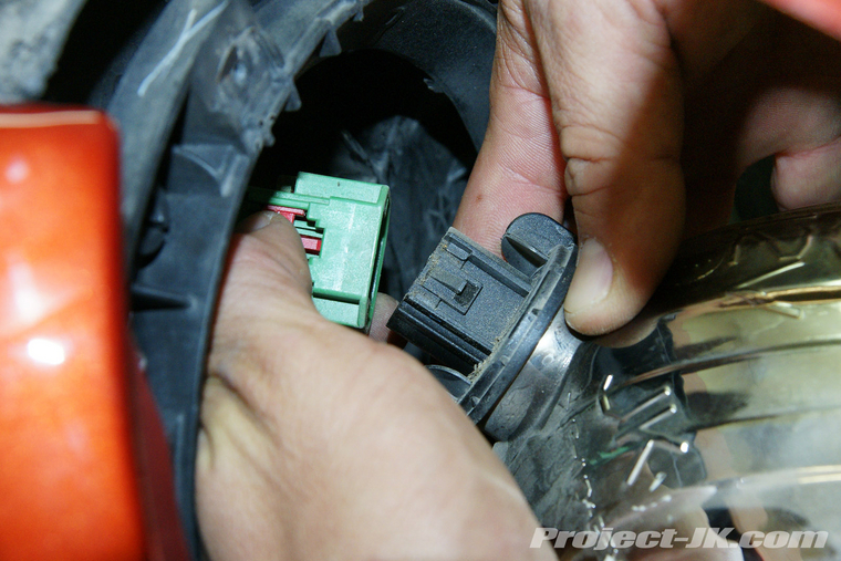

10. Press the release tab on the end of the wiring harness plug and then pull it out.

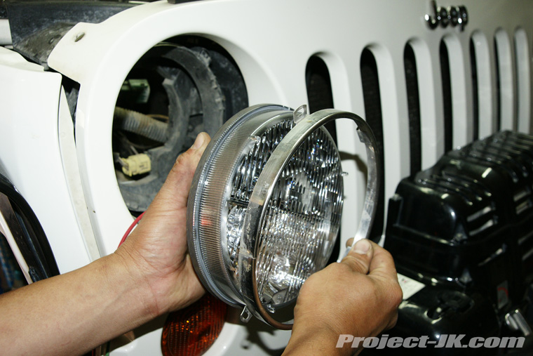

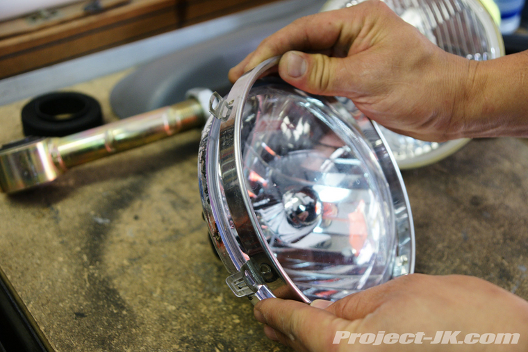

11. Separate the retaining ring from the factory headlight housing as shown.

13. Plug the Truck-Lite LED into the wiring harness on your JK, place the factory retaining ring over the headlight and then position it so that all the indexing tabs line up with the appropriate mounting holes.
14. Secure the retaining ring and Truck-Lite LED headlights in place using the factory screws. A Torx T-15 driver will be needed for this job.
15. Reinstall your front grille, secure it in place using the factory retaining tabs or screws, reconnect your battery lead and test out your new Truck-Lite LED headlights.

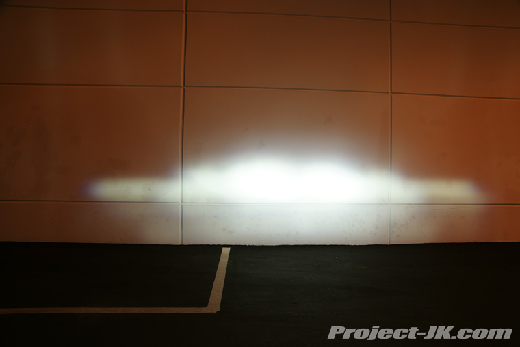

This is a shot on a wall to show what the projected low beam pattern looks like. As you can see, the spread extends wide to the outside and does well to fill in the space below as well.
