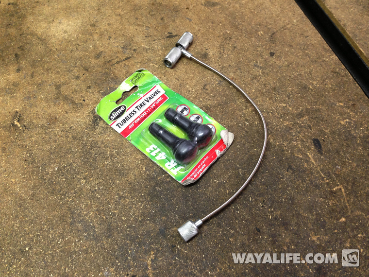

This is a shot of what the replacement valve stems you'll need look like as well as the tool required to install them. The tool can be purchased from Off Road Evolution.

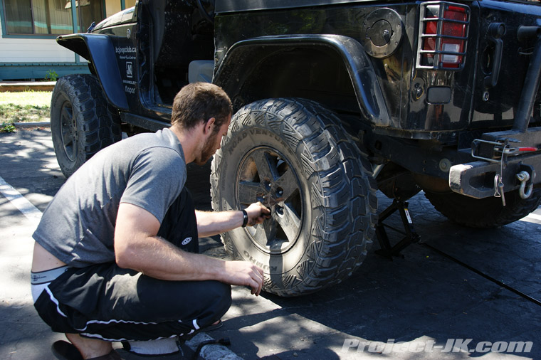

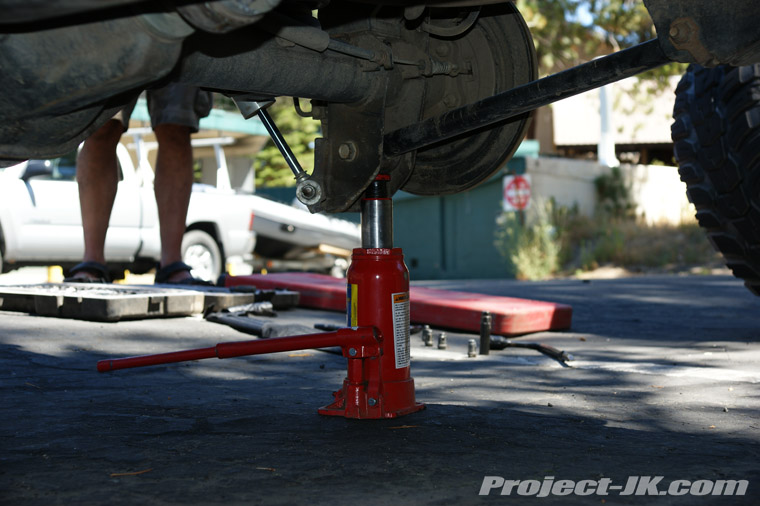

1. Using a lug wrench or 19mm socket, crack the lug nuts loose on the wheel you need to repair. Use a jack to raise your Jeep from the base of your axle's differential or control arm joint and proceed to remove the wheel.

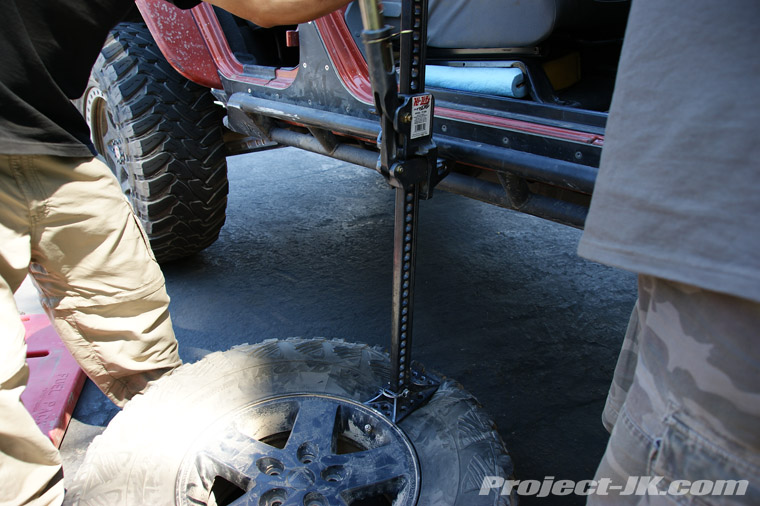

2. Place your tire under the rocker guard of another Jeep making sure that the sidewall and vavle stem are directly under it. Then, place the base of your Hi-Lift jack on the side wall and begin lifting the Jeep from the rocker guard as shown. This step will not actually raise your Jeep but rather, will break the bead of the tire.

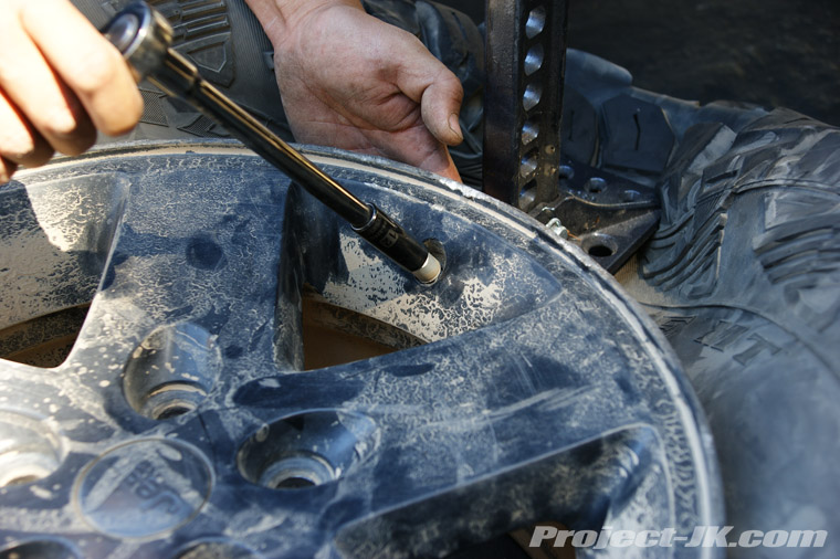

3. Use a deep 12mm socket to remove the TPMS retaining nut.
4. With the retaining nut removed, you should be able to simply pull out the TPMS sensor.

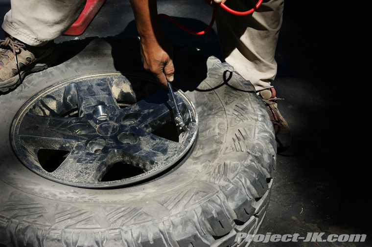

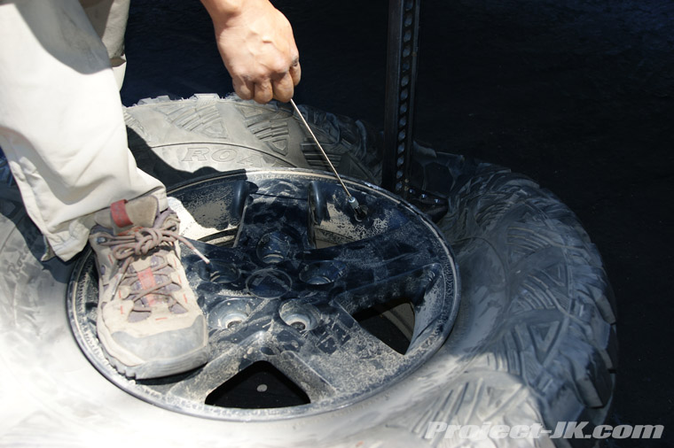

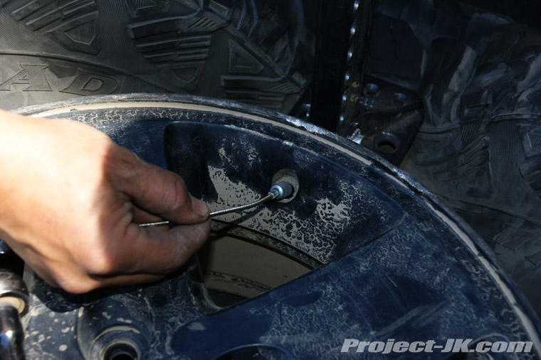

5. Insert the valve stem installation tool through the valve hole in valve hole in your wheel.

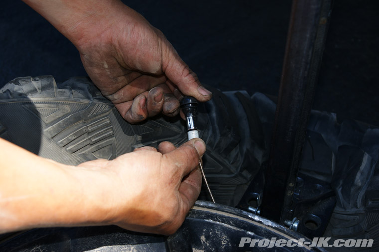

6. Affix your new replacement valve stem onto the installation tool as shown.
7. Carefully pull the new valve stem through the hole in your wheel until it pops in place. Being that you're just using a standard valve stem, no retaining nut will need to be installed.

Awesome write up I wondered if it was possible to do on the trail. Anyone ever done it when they were out alone. I guess you could break the bead some other way.
If you have a Hi-Lift handy and a place on your Jeep where you can work off of, you can do this on your own. If you don't, I have been able to break the bead enough to work on the TPMS by driving on top of the sidewall. Of course, it'll only work on tires with thinner sidewalls and you'd have to swap in your spare first to do it.
This is what I've done when someone I was wheeling with didn't have a spare. I think I would just plan to swap in my spare on the trail and then, (heaven forbid) another tire is needed, decide which of the two is an easier trail repair.
