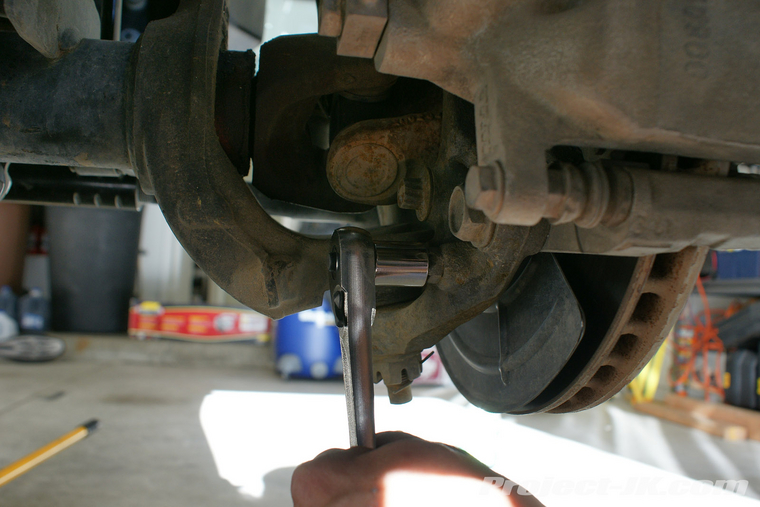

1. The steer stops on a Jeep JK Wrangler are located on the back side of the steering knuckles as is indicated by the arrow in this pic.
2. Using a 9/16" socket, remove the steer stop bolt.

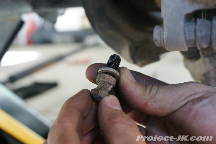

3. Place a 3/8" washer onto the steer stop bolt.

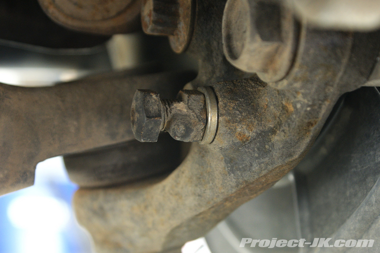

4. Reinstall the steer stop bolt and washer back onto the steering knuckle.
5. This is what your steer stop bolt should look like when all is said and done. Although it may not look like much, this little washer will most likely be all that you need to fix your rubbing. If you still have rubbing issues, you can always add another washer or two but remember, the more washers you add, the more you will increase your Jeeps turning radius or, reduce it's ability to make tighter turns.
