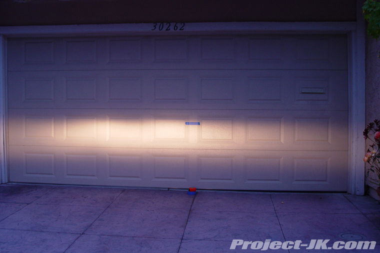

1. Park your Jeep 25′ back from a garage door or wall. Affix a strip of blue masking tape 3′ up from the ground. If you’ve just lifted your Jeep, you will see that your headlights are pointing above the tape as shown in this pic.

4. Using your Torx T-15 driver, turn the adjustment screw counter-clockwise until your headlight is pointing just below the blue tape on the garage or wall you attached it to.
And that’s all there is to it, you’re done. You should now have headlights with beams that point where they should be and not into the eyes of on-coming traffic.
