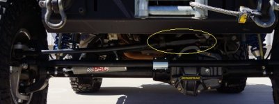

One thing on the drag link: Unless you're running a high steer setup, you may have to run the factory drag link. With the Dynatrac D60 front, they include an extension buckle so you can use the factory link. I had a Rare parts aluminum DL but can't re-use it because of clearance issues. There isn't enough real estate for the bar and end to fit on the knuckle.
I'm not overly worried about it - Rubicat ran that setup with hydro and there are a lot of others running the factory link. Spares for those are cheap too.
I circled the Dynatrac knuckle on Rubicat below
