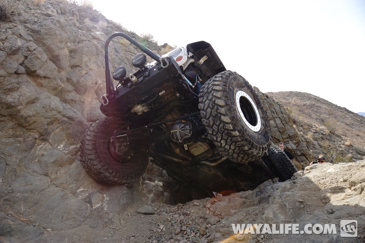

It might be a bit hard to see it in this pic but the stars on the Spyderlocs we had on Moby were not only beat up but bent in. It was enough to cause balancing issues and we ended up having to replace a couple - which by the way isn't cheap!
