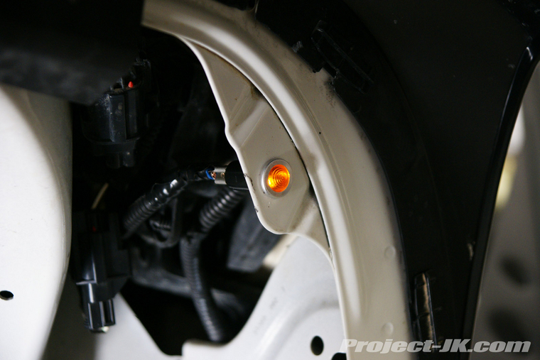

Millerj87 New member Jan 1, 2014 #1 To all with cut or aftermarket fenders what are you using for side marker lights? And where did you mount them? Sent from my iPhone on the west coast of florida

wayoflife Administrator Staff member Jan 1, 2014 #3 I picked up some panel lights from PepBoys, drilled out an existing hole on the fender and installed them there like this: I have it all here in my write-up: http://project-jk.com/jeep-jk-write-ups/jeep-jk-wrangler-factory-fender-chop

pvanweelden New member Jan 1, 2014 #4 I have led's to put in like ^ Eddie suggested, but until then I just zip tied the factory markers to the grill

Millerj87 New member Jan 1, 2014 #5 Thanks Eddie I have similar LEDs but was unsure of where to mount them this clears it up thank you sir! Sent from my iPhone on the west coast of florida
