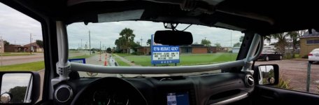

Looks good! Did you have to trim the hard top roof panels too? Definitely agree on the Rock Hard route.
Yes, I had to trim some of the freedom panels where the knuckles mount. When they are installed you cannot tell they were modified. There is no leaking due to this. EASY!!!
