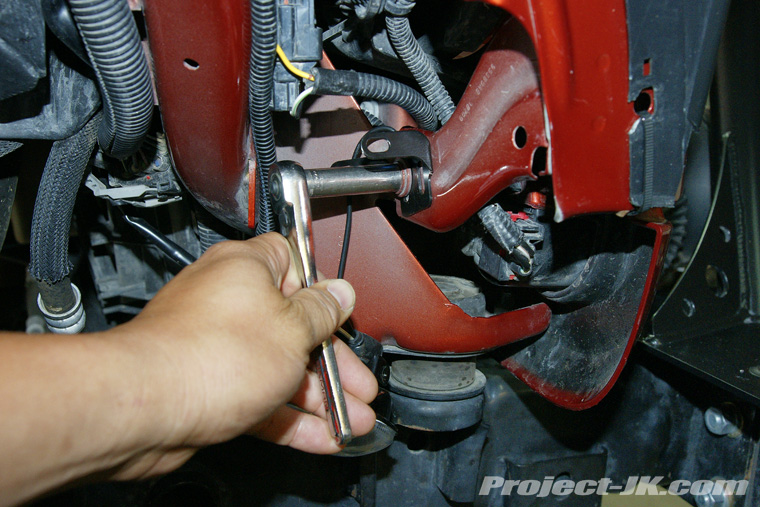

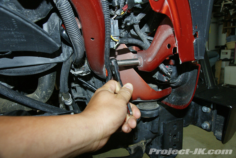

1. Begin the installation of your rock lights by removing the bolt securing the grill support to the sub-structure of your JK’s body.

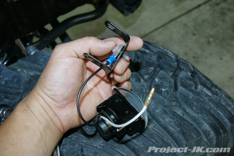

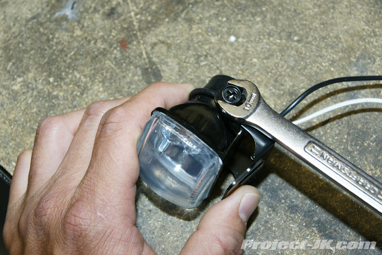

2. Using a 10mm wrench, remove the 2 bolts securing the Platinum Burner light to the mount.

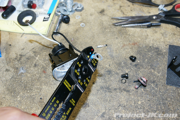

3. The ring terminals leads provided are too small and so you will need to cut the black ground wire next to the connector plug as shown.

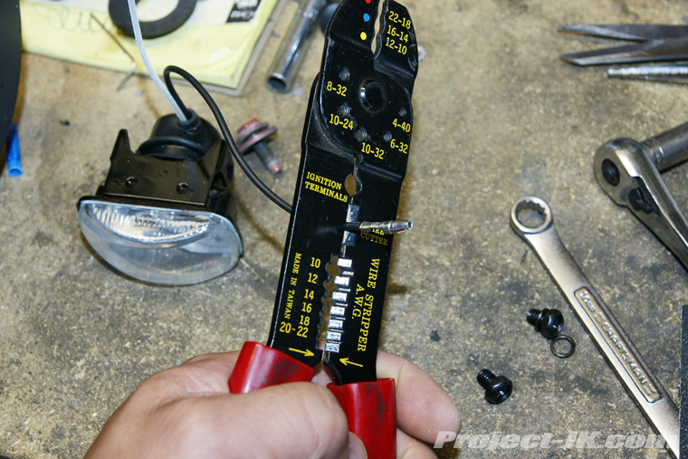

4. Strip the black ground wire and then, using a solderless connector crimp tool, attach a ring terminal to the end of the wire.

6. Using a 10mm socket, install the Platinum Burner light mount onto the sub-frame of your JK body.

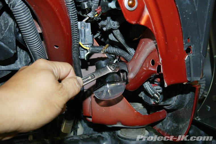

7. Using a 10mm wrench and the bolts that came with the kit, install the Platinum Burner lights onto the mounts.

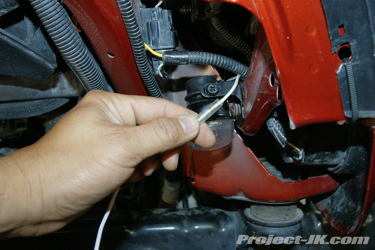

8. Connect the shorter pre-terminated wires provided with the kit onto the leads extending from the Platinum Burner lights.

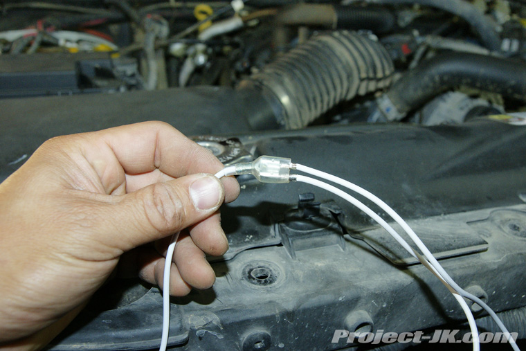

9. Connect the 2 white wires extending from both Platinum Burner lights into the coupling attached to the long white wire provided as shown.

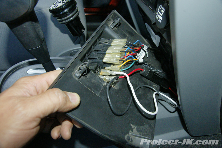

11. Reach through the air vent hole and push out the side panel of your dash as shown. Remove the panel and set it aside. If you have a 2011 or newer JK, simply use a trim pry tool to remove this panel.

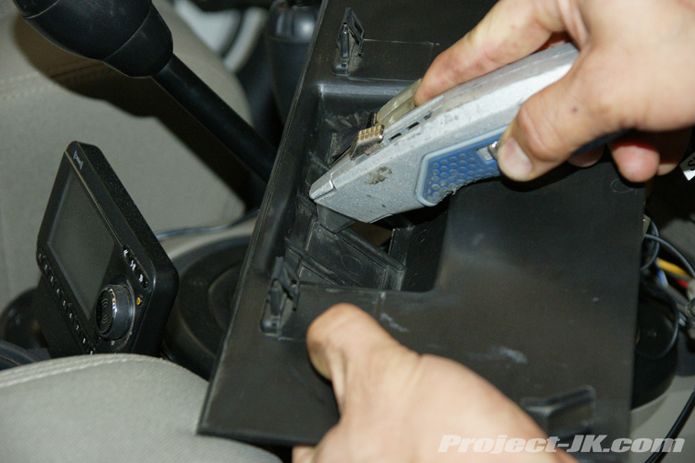

18. If you are using a Daystar Dash Panel, use a utility knife to cut out one of the light switch ports.

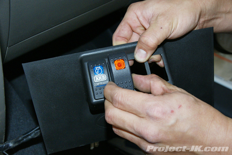

19. The switch that comes with the kit is on the narrow side and will not fit in the Daystar Switch Panel ports. So, I bought and installed a new switch that would fit.
