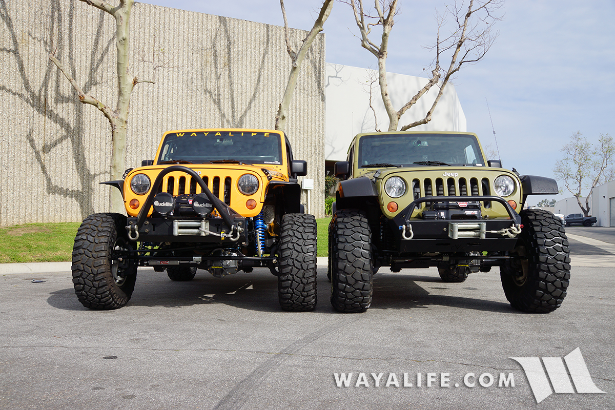

So, here's an interesting comparison that'll help put some perspective on things. On the left, you have Rubicat with her new 72.5" XD60 front axle with PRO 1550 steering knuckles and running Trail Ready bead lock wheels that have 5.5" of back spacing. On the right, you have Moby running a standard 68.5" ProRock 60 front axle with Pro 60 steering knuckles and running ATX Chamber Pro II bead lock wheels that have 4" of back spacing. While Moby's tires are 40" tall, they're still only 13.50" wide just like Rubicat's tires and in spite of the 4" axle width difference, both Jeeps measure 85" wide from the outside edge of tire to tire.

Here are a few parting shots of both Rubicat and Moby side by side.
