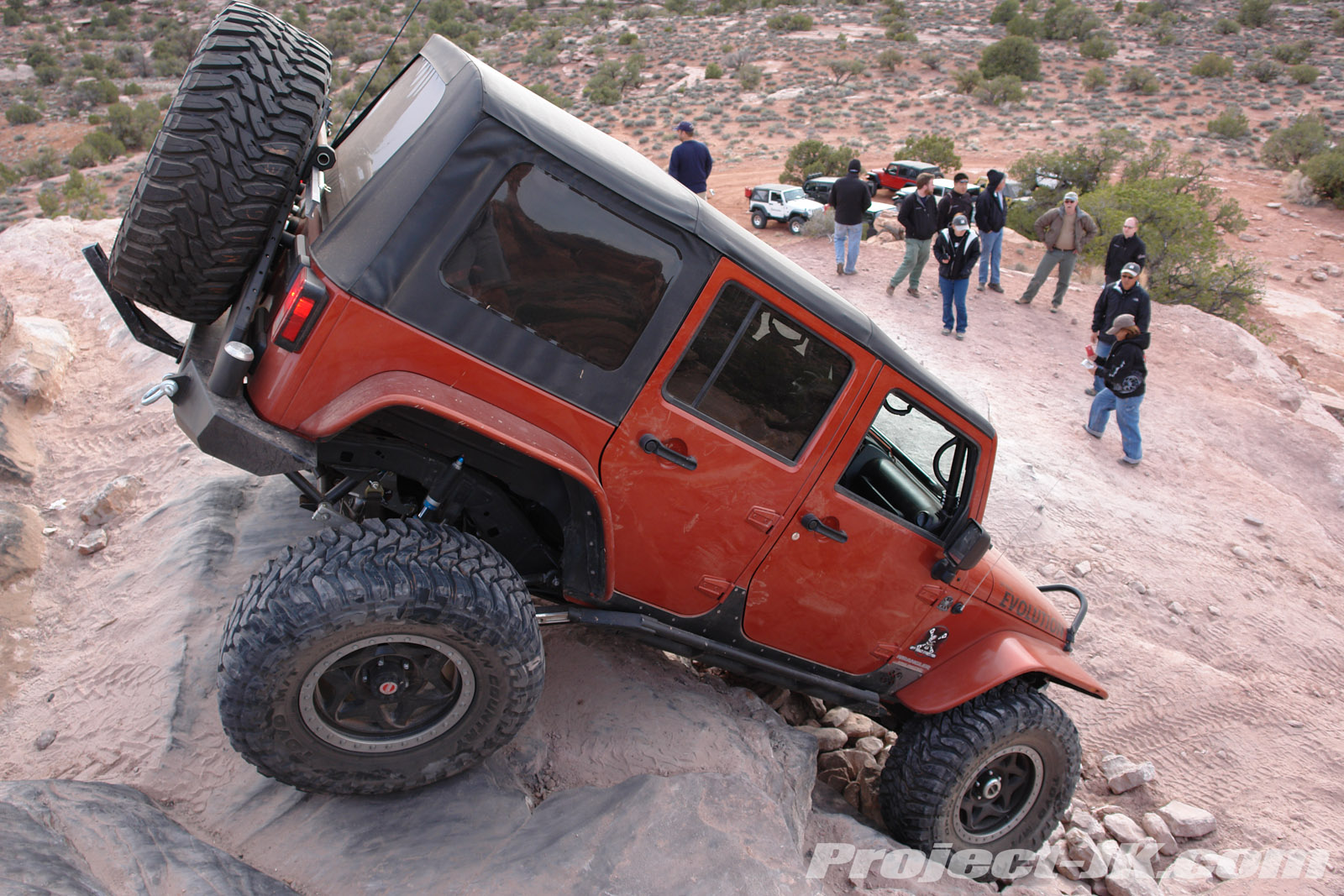

Here is a pic...

Here is a few picture!
They work real well for the their purpose but as Wol said they are a pain!

Ray's made a bunch as you can see in the pic above. Hey Ray, you got anymore of those laying around? You might have a Canuck interested in one. :D
