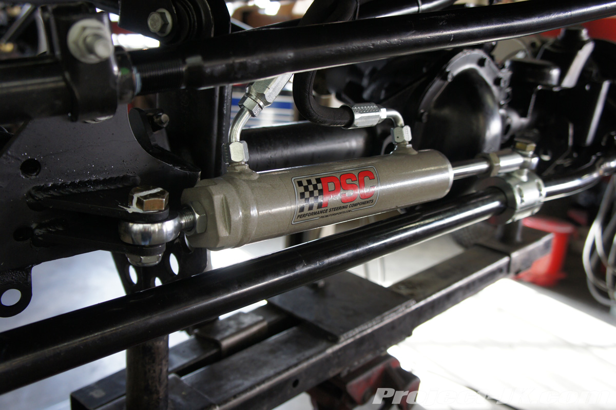

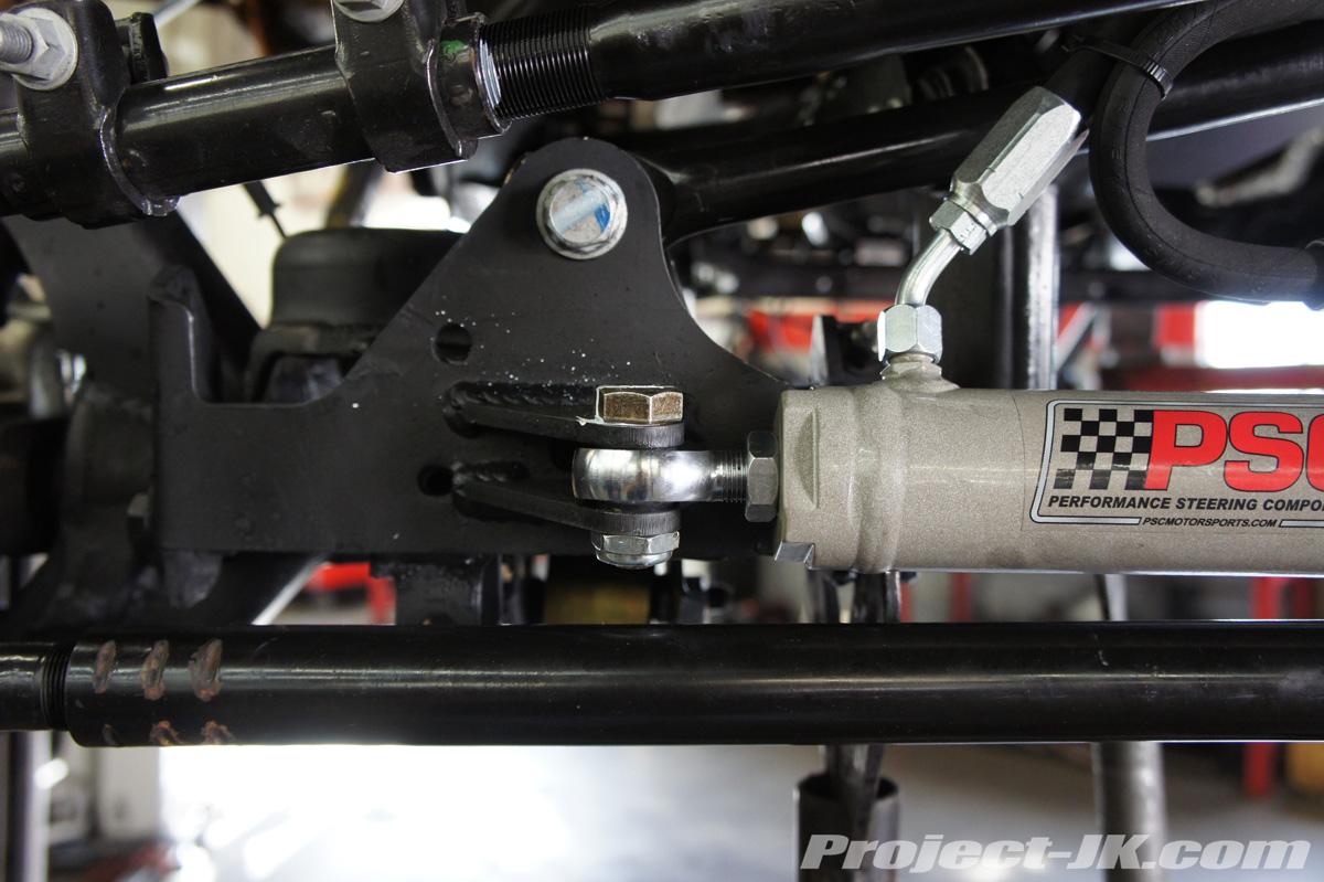

You're best bet is to have mounting tabs welded onto the track bar relocation bracket like this....
That being said, if you haven't done it already, you really want to make sure that you burn on the track bar relocation bracket to the axle.
You can burn the tabs on like Eddie suggested but I can't stress enough to have the track bar bracket burned onto the axle tube. The ram will just move that thing around if it's just bolted on there.
I run a synergy raised bracket on my PR44 so you could always go that route as well.
