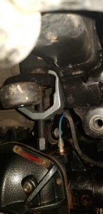

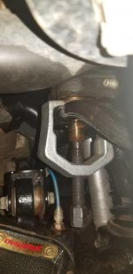

Ok gents I'm at a loss here. How hard should the damn pitman arm be to come off. After 3 puller rentals I finally have one the right size that clears the track bar bracket. I have been cranking on this thing with a breaker bar and a pipe extender. Finally resorted to the impact gun and it's bending the puller and not coming off. Without risking breaking the rental and throwing parts under a ton of torque is this normal?
I've been soaking it in PB blaster the last few days and am putting my strongest impact to it, not sure what else I can do.
Any tips would be appreciated
Pic for reference
Seated side
Side that is bending out

Pic for reference
Seated side
