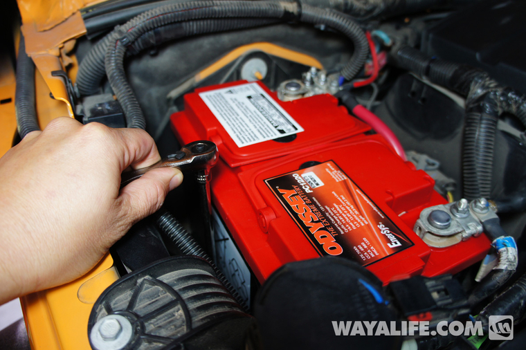

1. Using a 10mm socket or wrench, loosen the clamp nut from the negative terminal of your battery and then disconnect it. Repeat on the positive terminal.
2. Use a 10mm socket attached to a long extension to remove the bolt and clamp securing the base of your battery to its tray.

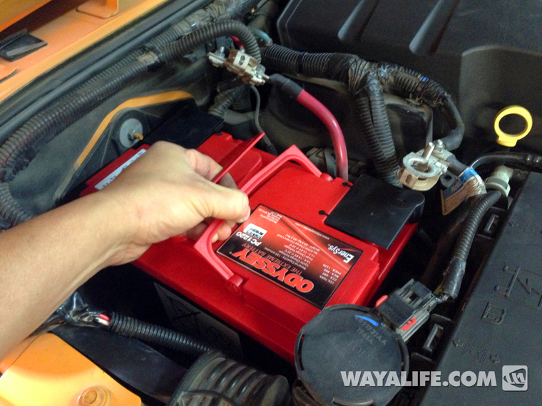

3. Remove the old battery and replace it with your new Odyssey Extreme Series one.
4. Reinstall the battery base clamp and secure it in place with the factory bolt. You will need a 10mm socket attached to a long extension for this job.

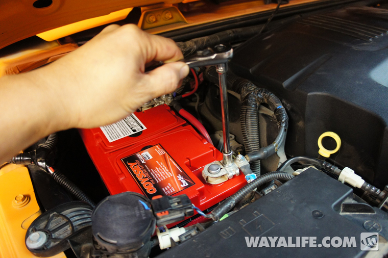

5. Reconnect the positive and then negative leads to your new battery and then, tighten up the terminal clamp nuts to secure them in place.
